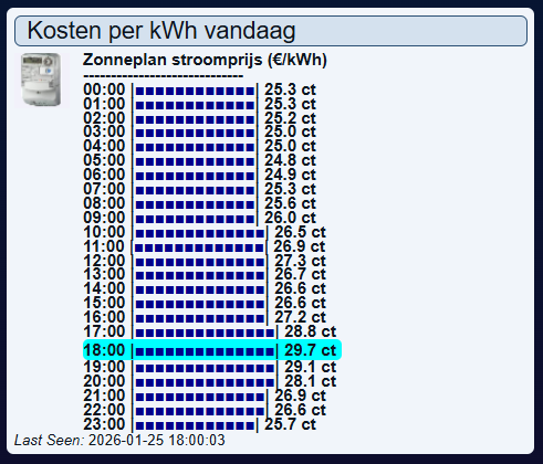

Maybe you could use the build in Enever hardware?
Posts: 6676
Domoticz version: 2025.1
Re: Dutch dynamic energy prices bar chart in Custom menu
What is the difference with the price graphs from the existing Enever plugin?

FYI. If Domoticz has grabbed the data from Enever it's stored in User variables.
Using the data from this User variable i made a script that in a text-device shows the today price in a bargraph.
The script runs every hour without polling the Enever server each time.
In the script the current price is highlighted in the chart.

RonkA
Posts: 126
Joined: Tuesday 14 June 2022 12:57
Location: Harlingen
Post by RonkA »
The script runs every hour to highlight the current price, so yeah..
SolarEdge ModbusTCP - Kaku - Synology NAS - Watermeter - ESPEasy - DS18b20
