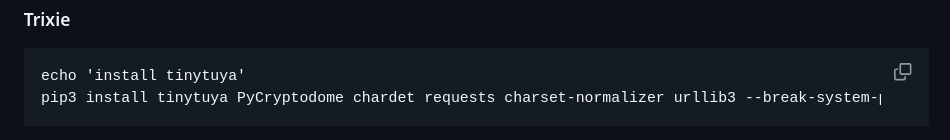

Python 3.13 are you in trixie? if so there is part on the Readme for Trixie, that includes the install of the missing urllib3 python module.
Schermafdruk van 2026-01-23 22-22-40.png (14.19 KiB) Viewed 88 times
I have run this this since I reinstalled using Docker. Something has happen with.
I'll test installing

Varazir wrote: Friday 23 January 2026 22:16 Did a git pull and restarted domoticz docker
2026-01-23 22:15:20.728 Error: TinyTUYA: (tinytuya) failed to load 'plugin.py', Python Path used was '/opt/domoticz/userdata/plugins/Domoticz-TinyTUYA-Plugin/:/opt/domoticz/userdata/Domoticz_Python_Environment:/opt/venv/lib/python3.11/site-packages:/usr/lib/python313.zip:/usr/lib/python3.13:/usr/lib/python3.13/lib-dynload:/opt/venv/lib/python3.13/site-packages:/opt/venv/local/lib/python3.13/dist-packages:/opt/venv/lib/python3/dist-packages:/opt/venv/lib/python3.13/dist-packages'.
2026-01-23 22:15:20.797 Error: TinyTUYA: Traceback (most recent call last):
2026-01-23 22:15:20.797 Error: TinyTUYA: File "/opt/domoticz/userdata/plugins/Domoticz-TinyTUYA-Plugin/plugin.py", line 73, in <module>
2026-01-23 22:15:20.797 Error: TinyTUYA: import requests
2026-01-23 22:15:20.797 Error: TinyTUYA: File "/opt/domoticz/userdata/Domoticz_Python_Environment/requests/__init__.py", line 43, in <module>
2026-01-23 22:15:20.797 Error: TinyTUYA: import urllib3
2026-01-23 22:15:20.798 Error: TinyTUYA: File "/opt/domoticz/userdata/Domoticz_Python_Environment/urllib3/__init__.py", line 7, in <module>
2026-01-23 22:15:20.798 Error: TinyTUYA: from .connectionpool import HTTPConnectionPool, HTTPSConnectionPool, connection_from_url
2026-01-23 22:15:20.798 Error: TinyTUYA: File "/opt/domoticz/userdata/Domoticz_Python_Environment/urllib3/connectionpool.py", line 11, in <module>
2026-01-23 22:15:20.798 Error: TinyTUYA: from .exceptions import (
2026-01-23 22:15:20.798 Error: TinyTUYA: ...<13 lines>...
2026-01-23 22:15:20.798 Error: TinyTUYA: )
2026-01-23 22:15:20.798 Error: TinyTUYA: File "/opt/domoticz/userdata/Domoticz_Python_Environment/urllib3/exceptions.py", line 2, in <module>
2026-01-23 22:15:20.798 Error: TinyTUYA: from .packages.six.moves.http_client import IncompleteRead as httplib_IncompleteRead
2026-01-23 22:15:20.798 Error: TinyTUYA: ModuleNotFoundError: No module named 'urllib3.packages.six.moves'
