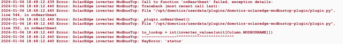

I installed domoticz in a Docker container and placed the data in a volume called domoticz_data to prevent data loss during a subsequent pull. The SolarEdge Modbus Python plugin is now installed in the data volume path root@44929adebcd4:/opt/domoticz/userdata/plugins#. However, the plugin occasionally returns an error. It appears the plugin is searching for/using the original location of the plugin path /opt/domoticz/userdata/plugins. How can I modify the plugin to prevent these errors?

- Screen Shot 2026-01-07 at 09.58.22.653 AM.png (41.48 KiB) Viewed 1539 times
- Screen Shot 2026-01-07 at 09.57.59.106 AM.png (119.55 KiB) Viewed 1539 times
- Screen Shot 2026-01-07 at 09.57.20.625 AM.png (35.15 KiB) Viewed 1539 times

The / is correct as from inside the container it is and should be in /opt/domoticz/userdata/plugins
How does your docker compose yaml file looks like?

The plugin gives an occasional error since I use it.
The thing is the Solaredge Modbus TCP seems not to be real actively maintained.
I plan to look into that, but that will take some time before I have ehm time.
What I sometimes see is that shortly after modbus has an issue also the Solaredge API gets the errors, mostly when the sun is not shining or the panels are otherwise not generating electricity.

I see also errors in your screenshot from the plugin manager plugin you have implemented? So it is not only the solaredge plugin that gives issues.
Perhaps it is an issue of your docker implementation that it sometimes cannot find the mounted volume? Is that a disk on the same system or a network disk?
Edit: It seems you have 2 issues:
1. Solaredge plugin just have an issue with communicating. Nothing to do with /
2. Plugin Manager (PluginList) plugin not able to locate the solaredge plugin.

Shouldn't the error in that case not occur always instead of occasionally?

I dont know both plugins but please treat your errors as 2 different problems.....
