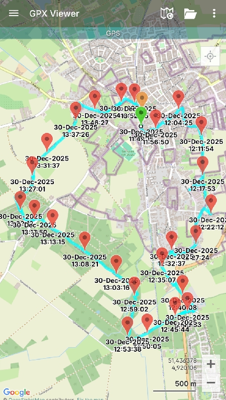

Added new functionality to the plugin, more specific using the device output of RawData: generate a GPX file that can be used to upload to for instance GPX Viewer (Android app). To be clear GPSLogger is also able to generate GPX output, however for the integration with Domoticz this feature cannot be used in parallel (as far as I'm aware).
Just start capturing the data for the GPX file, actually start the route to travel. Once the route is finished, stop capturing and a GPX file will be generated. The start/stop a capturing is just an on/off switch dummy device in Domoticz.
Output will look this
Synology DS920+ DSM7 (Docker) | Integrations: Audio, Heating, Gas, Electricity, Water, Alarm, Car, Camera, Doorbell, Garage, Garbage, Washer | SW: Tasmota, DzVents, Pushbullet, Telegram | Plugins: UPS, GPSLogger, BatteryLevel, Hyundai KIA, Rhasspy
