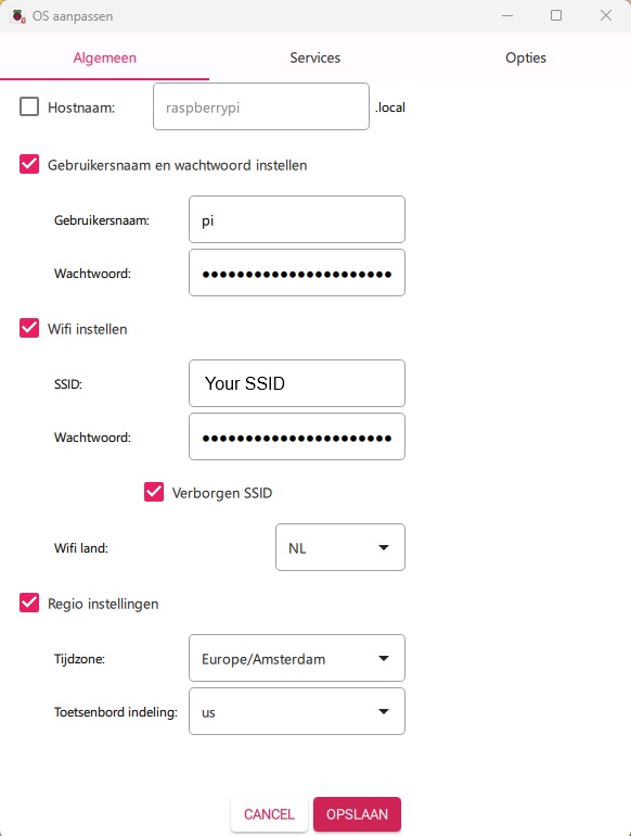

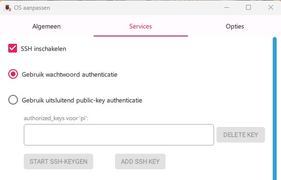

I have done a fresh Trixie install on a Rpi3B+, headless. I had to wait a few minutes before i could login. After this i installed Domoticz Stable 2025.2. No major problems, just a small problem with Z4D, but that was quick solved. Have you modified the settings in Raspberry Pi Imager?

I am using it for building Domoticz from scratch, but the pi won't boot without keyboard.
What is Z4D?
I do not use the imager, but I did the settings, first boot is always via monitor/keyboard.

Z4D is Zigbee for Domoticz. Was just for information, not a part of your problem.jannl wrote: Friday 24 October 2025 11:11 I am using it for building Domoticz from scratch, but the pi won't boot without keyboard.
What is Z4D?
I just need to check the timezone
I always use the Pi imager, have never problems with the first boot headless without connecting a keyboard/monitor

If you are using imager 1.96 there is a bug: [BUG]:Enabling SSH does not enable SSH #1242
See: https://github.com/raspberrypi/rpi-imager/issues/1242
I used an older version to write the image: https://github.com/raspberrypi/rpi-imager/releases

ssh is enabled, it just does not boot without a keyboard attached.
So far no luck with google/ai etc. I just bricked the OS on my ssd for some reason and started over again
