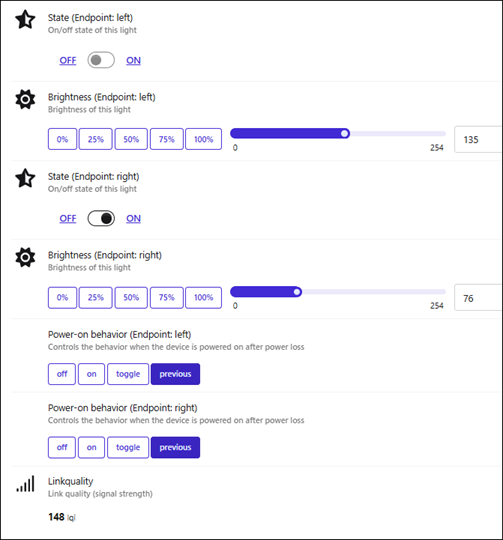

I recently purchased a dual ZigBee built-in dimmer. See: https://www.ecobright.nl/zigbee-duo-led ... igbee.html
I have integrated the control for this dimmer into in the situation described above using a separate script.
The dimmer It is linked to Domoticz via:
  • SONOFF Zigbee 3.0 USB Dongle Plus | ZBDongle-E
  • Zigbee2mqtt
  • MQTT
Initially, I had a bit of trouble getting this working. It turned out that zigbee2mqtt support had only recently been added or improved. (The device was already listed, but it still was not working properly and was not recognized at first.)
In my situation, however, an upgrade turned out to be necessary to current version at this moment:
Zigbee2MQTT-versie 2.7.1, commit: 8916fb7b, with Frontendversion 2.4.2, zigbee-herdsman-converters version 25.83.1 and zigbee-herdsman version 7.0.4.

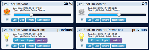

This resulted in immediate recognition of the dimmer in zigbee2mqtt and and also display in Domoticz.
I have hidden the ones for the power on behaviour, because once set up it does not need to be controlled from Domoticz for me.
