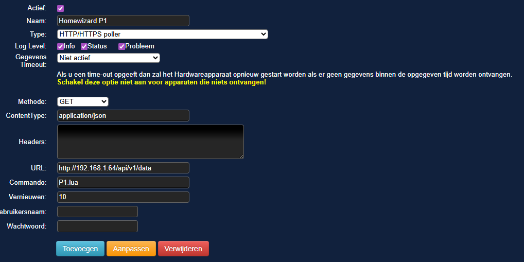

Attached is a screenshot of my HW P1 under hardware. It's the same as before the crash, I don't think there's something wrong with it.

For the HTTP Poller hardware look at the wiki https://wiki.domoticz.com/HTTP/HTTPS_poller
The P1.lua script has to be placed in folder domoticz/scripts/lua_parsers
In your domoticz log there should be errors like
Error: CLuaHandler: cannot open /home/.../domoticz/scripts/lua_parsers/P1: No such file or directory
That should also give you a clue....

Put the lua script above here in the mentioned folder and got energy/ gas meter up and running.
