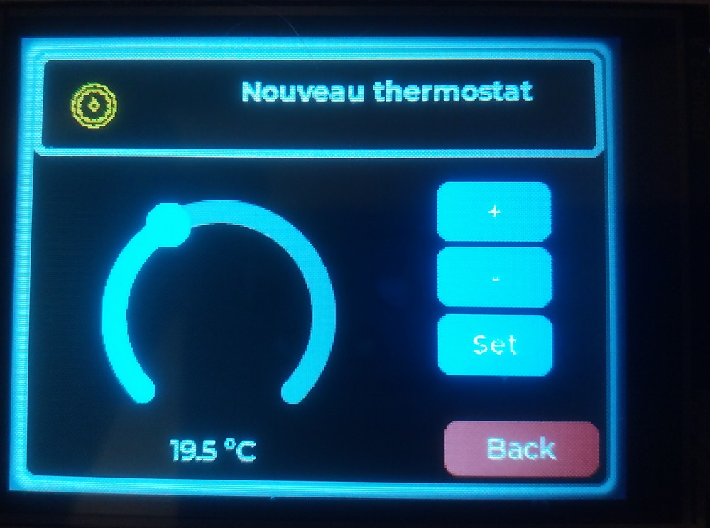

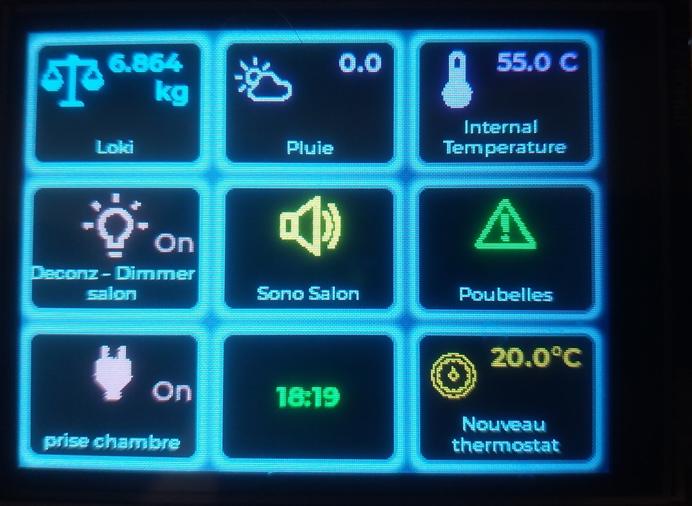

Ok, so the code is updated on branch "test"
Not official yet, because I need to re-test all widgets, it seems some libs was updated and have broked some features.
But I have added the weight widget (I need it for my cat) and have improved the thermostat widget, now it support min/max/step, I m using an "arc" widget instead of a "slider".
And If you are using the new "mixed" thermostat (the same widget can be used for temperature and setpoint), you have the temperature on the homepage, but if you select the widget you have access to the setpoint.
Have corrected the dimmer slider, it send request only on release, not during the selection with the finger.
