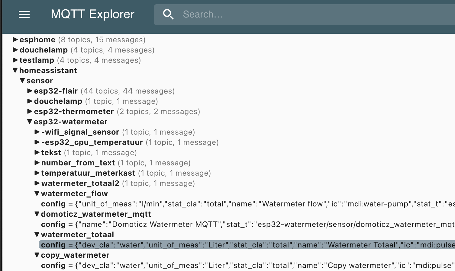

ok, when. i look in MQTT i see this posted
{"dev_cla":"water","unit_of_meas":"Liter","stat_cla":"measurement","name":"Watermeter Totaal","ic":"mdi:pulse","stat_t":"esp32-watermeter/sensor/watermeter_totaal/state","avty_t":"esp32-watermeter/status","uniq_id":"ESPsensorwatermeter_totaal","dev":{"ids":"ecda3bc02bcc","name":"ESP32-Watermeter","sw":"2025.10.4 (Nov 21 2025, 18:24:16)","mdl":"esp32-c3-devkitm-1","mf":"Espressif","cns":[["mac","ecda3bc02bcc"]]}}Code: Select all
{"unit_of_meas":"l/min","stat_cla":"measurement","name":"Watermeter Pulse","ic":"mdi:water-pump","stat_t":"esp32-watermeter/sensor/watermeter_pulse/state","avty_t":"esp32-watermeter/status","uniq_id":"ESPsensorwatermeter_pulse","dev":{"ids":"ecda3bc02bcc","name":"ESP32-Watermeter","sw":"2025.10.4 (Nov 21 2025, 17:32:58)","mdl":"esp32-c3-devkitm-1","mf":"Espressif","cns":[["mac","ecda3bc02bcc"]]}}
{"unit_of_meas":"l/min","stat_cla":"measurement","name":"Watermeter flow","ic":"mdi:water-pump","stat_t":"esp32-watermeter/sensor/watermeter_flow/state","avty_t":"esp32-watermeter/status","uniq_id":"ESPsensorwatermeter_flow","dev":{"ids":"ecda3bc02bcc","name":"ESP32-Watermeter","sw":"2025.10.4 (Nov 21 2025, 18:24:16)","mdl":"esp32-c3-devkitm-1","mf":"Espressif","cns":[["mac","ecda3bc02bcc"]]}}

}this what is send to MQTT
the pulse_meter in esphome consists of 2 devices, pulse and total
total
topic
homeassistant/sensor/esp32-watermeter/watermeter_pulse/configCode: Select all
[quote][code]{"dev_cla":"water","unit_of_meas":"Liter","stat_cla":"total","name":"Watermeter Totaal","ic":"mdi:pulse","stat_t":"esp32-watermeter/sensor/watermeter_totaal/state","avty_t":"esp32-watermeter/status","uniq_id":"ESPsensorwatermeter_totaal","dev":{"ids":"ecda3bc02bcc","name":"ESP32-Watermeter","sw":"2025.10.4 (Nov 22 2025, 07:35:34)","mdl":"esp32-c3-devkitm-1","mf":"Espressif","cns":[["mac","ecda3bc02bcc"]]}}flow
topic
homeassistant/sensor/esp32-watermeter/watermeter_pulse/configpayload
{"unit_of_meas":"l/min","stat_cla":"total","name":"Watermeter flow","ic":"mdi:water-pump","stat_t":"esp32-watermeter/sensor/watermeter_flow/state","avty_t":"esp32-watermeter/status","uniq_id":"ESPsensorwatermeter_flow","dev":{"ids":"ecda3bc02bcc","name":"ESP32-Watermeter","sw":"2025.10.4 (Nov 22 2025, 07:35:34)","mdl":"esp32-c3-devkitm-1","mf":"Espressif","cns":[["mac","ecda3bc02bcc"]]}}-
unit_of_measurement: "m³"
state_class: total
device_class: energy
icon: "mdi:pump"
accuracy_decimals: 0
filters:
lambda: |-
if (isnan(id(num_from_text).raw_state)) {
return x + id(domoticz_watermeter_value).state;
} else {
return x + id(num_from_text).state;
}- waltervl

agreed but it could well be that Gizmocuz will react with" Nothing wrong" because the things are detected in a strange way.
however i also filed a request on github regarding the waterflow.
it will not detect it correctly unless i specify l/hr
i asked for a second line of code which will also respond if the measurement unit is l/min.

Both issues fixed by GizMocuz in latest beta......Gravityz wrote: Monday 24 November 2025 8:26 agreed but it could well be that Gizmocuz will react with" Nothing wrong" because the things are detected in a strange way.

i think this is the 2025.2 release.
i must say, inspecting the MQTTautodiscover.cpp gives you a lot of insight.
code is complex but it is easy to spot where things go wrong(in my case with the l/min)
i will wait for the new docker image which is behind the normal release
