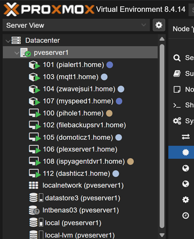

I am very happy that I use ProxmoxVE. Always taking a full VM backup before upgrading. Mostly the included DZ update auto backup function is cool, but not always sufficient...
Proxmox already saved me a lot of time... backup (snapshot) is restored in minutes....
I did change hardware today. Now fully operational on Odroid H4 Ultra with the extra Netcard (4 ports).
Just moved the SSD's to the new Odroid and altered the network settings ( bridge and bridge-host)
https://www.hardkernel.com/shop/odroid-h4-ultra/
