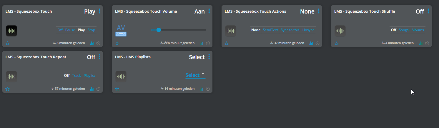

Python PLugin : Lyrion Music Server
I've made a Plugin for the Lyrion Music Server, formaly known as Logitsch Media Server
The buildin plugin still works, but is a bit limited
There are not mpw devices and functionalities added.
I've tested the plugin and it is working, but of course the can always be some issues.
The plugin is not tested with multiple devices
Please share you findings
You can find the plugin over here : https://github.com/MadPatrick/domoticz_Lyrion
