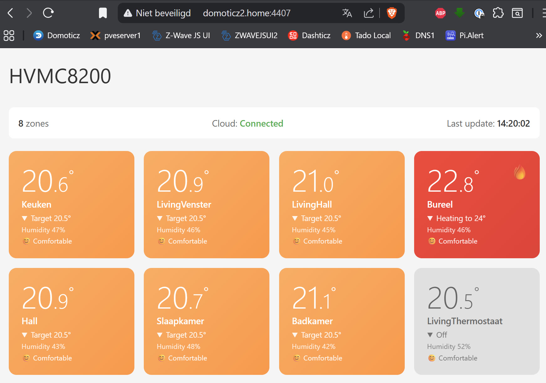

Installed the TadoLocal environment on my domoticz test system.
Local UI works fine on localhost:4402... and is getting changes when I alter a temperature set in Tado App... but setting a temperature setpoint from TadoLOcal does not work. Also I get errormsg : no leader device for zone...
Getting plugin in domoticz too... working... all devices are installed... But when trying to set a higher temperature for a zone: error
2025-11-10 14:07:03.101 Error: TadoLocal: Failed to connect to Zones Fetch: Connection refused (Status: 111)
2025-11-10 14:07:33.254 Error: TadoLocal: CConnection_disconnect, disconnection request from 'TadoLocal' ignored. Transport does not exist.
2025-11-10 14:07:33.364 Error: TadoLocal: CConnection_disconnect, disconnection request from 'TadoLocal' ignored. Transport does not exist.
What did I miss?
Python requirements for Domoticz plugins are OK....
What did I miss?

There is seperate TadoLocal topic and I think you better also create an issue on github.

Is there an overview somewhere showing which functionality TadoLocal offers?
In the screenshot it shows the different zones. I assume you can manually change temperatures.
But can you change the programming schedule? times/temperatures per day?

This is the current functionality with the plugin:manjh wrote: Tuesday 11 November 2025 12:33 Is there an overview somewhere showing which functionality TadoLocal offers?
https://github.com/AmpScm/TadoLocal/blo ... /README.md
