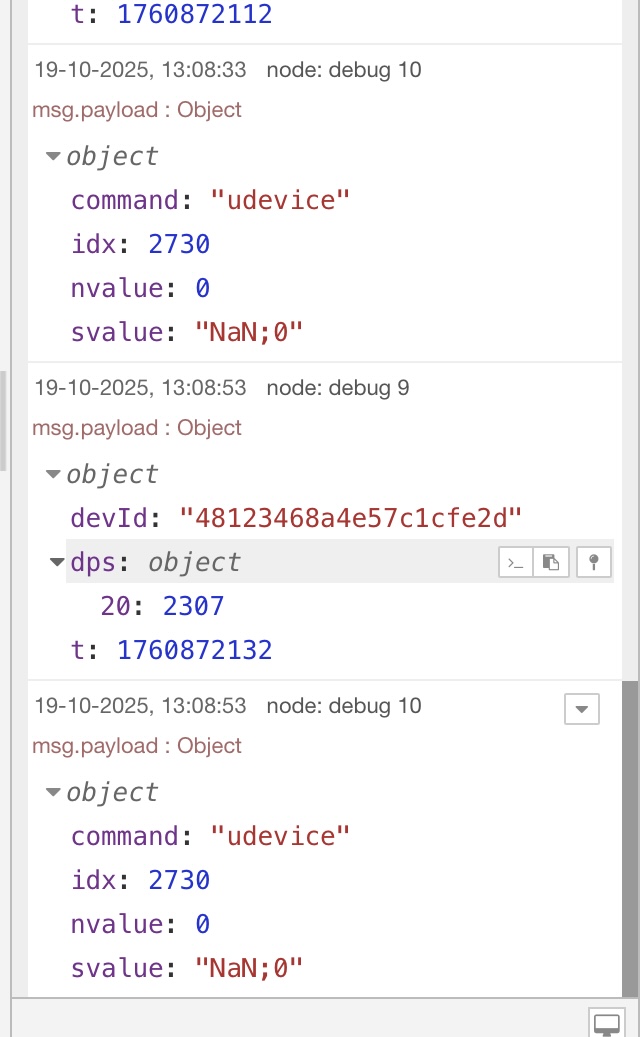

I see that sometimes there is a nan value in the debug:
Sorry but with plug i meant the tuya socket itself.
I dont understand it myself anymore either
Now domoticz is giving me also an error for sending the wrong value for my enphase solar system from node red.
But thats another problem.
Could it be that something changed in node red?
- IMG_6604.jpeg (188.63 KiB) Viewed 4380 times

Hello @edwin1234,
Thanks for the answer.
Sorry for my previous responses, but I have been focussed to much on the refrigerator, but now I understand it is just a Smart plug with Tuya protocol
In the picture I see now a NaN in debug 10.
I cannot see it, as your "tree" is closed.
Can you click on the black arrow so that the tree opens and the source of that NaN becomes visible?
Send it again.

edwin1234
- Posts: 341
- Joined: Sunday 09 October 2016 20:20
- Domoticz version: 2021.1
- Location: Nederland
Re: Node red flow
Is nothing more to see i think

Hello @edwin1234,
Thank you.
Now I understand what is happening.
Let me explain:
The dps values send by your Tuya smart plug are changing.
I use the table, that I found at: https://github.com/dulfer/localtuya-device-datapoints
and more specifically the table for Tuya v3.3 DPs, although I do not know, if your device is a v3.3.
You see that DP ID 19 is the Power and DP ID 20 is the Voltage.
So in your message from 13:08:53 only dps: 20 has been sent. This means only the Voltage, which is 230.7 V (the value divided by 10) is available.
But this message triggers the next (Function) node and the missing Power DP 19 is interpreted as NaN and that is send by MQTT (or HTTP, if you wish) to Domoticz. Honestly, I missed it in the table Tuya v3.3. It is stated:
Replace your existing flow with the one below:
Replace the Inject node with the Tuya node and use your own MQTT settings.
Let me know.
Thank you.
Let me explain:
This is just a matter of testing, that DPS ID 19 exist.List of DPs for Tuya v3.3 devices.
Table contains the DPs that a device may expose. In general it is a useful lookup table to identify the DPs read by LocalTuya.

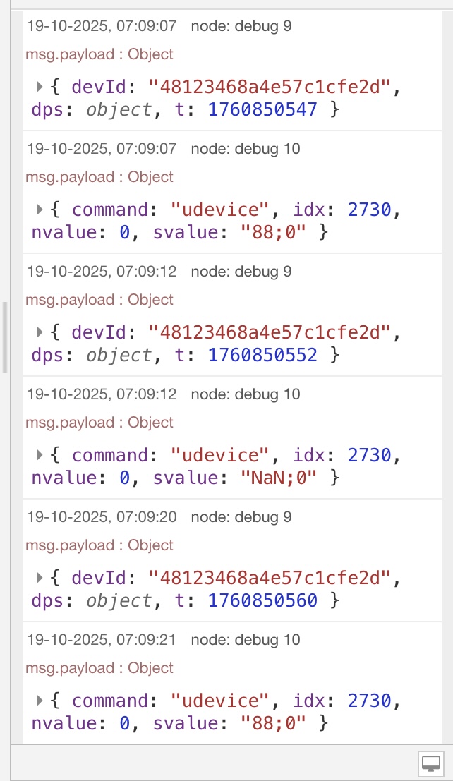

edwin1234
- Posts: 341
Re: Node red flow
Amazing that u figured that out.
I will try the new flow for a couple of hours and let you know the results.
Thank you very much.
