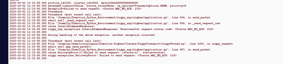

Same here.jandoedel wrote: Wednesday 01 October 2025 17:56Why is Domoticz-Zigbee not seeing this Branch?Code: Select all
pi@raspberrypi:~/domoticz/plugins/Domoticz-Zigbee $ sudo git switch rc-stable7.1.024 Already on 'rc-stable7.1.024' Your branch is up to date with 'origin/rc-stable7.1.024'.
Version is not updated in the software?
Plugin is running without problems
Edit:
After some time doing nothing, there is an error, see attachment
- Z4D_rc-stable_7_1_024_error.jpg (113.26 KiB) Viewed 5333 times

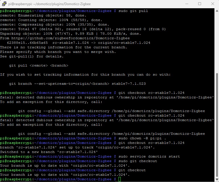

Rik60
- Posts: 233
- Joined: Sunday 25 June 2023 21:54
- Domoticz version: 2026.3
Re: Z4D has error after install
I switched to the rc again (following Pipiche):jandoedel wrote: Sunday 05 October 2025 17:00 how let you Rc stable 7.1.024 working.
I stuck with switching to Rc stable 7.1.024
what commands do jou used?
you can have the release candidate by doing a
git pull
git checkout rc-stable7.1.024
Do not the restart the plugin yet, but use WebUI -> Admin -> Plugin -> Plugin Update (to ensure all is correctly updated)
and then restart the plugin
After the git checkout rc-stable 7.1.024 i did a plugin update using the WebUI (WebUI version is still 7.1.023) but checkout is 7.1.024
This version of the plugin is now running without problems
- Z4D_rc-stable_7_1_024_ok.jpg (172.22 KiB) Viewed 5284 times
