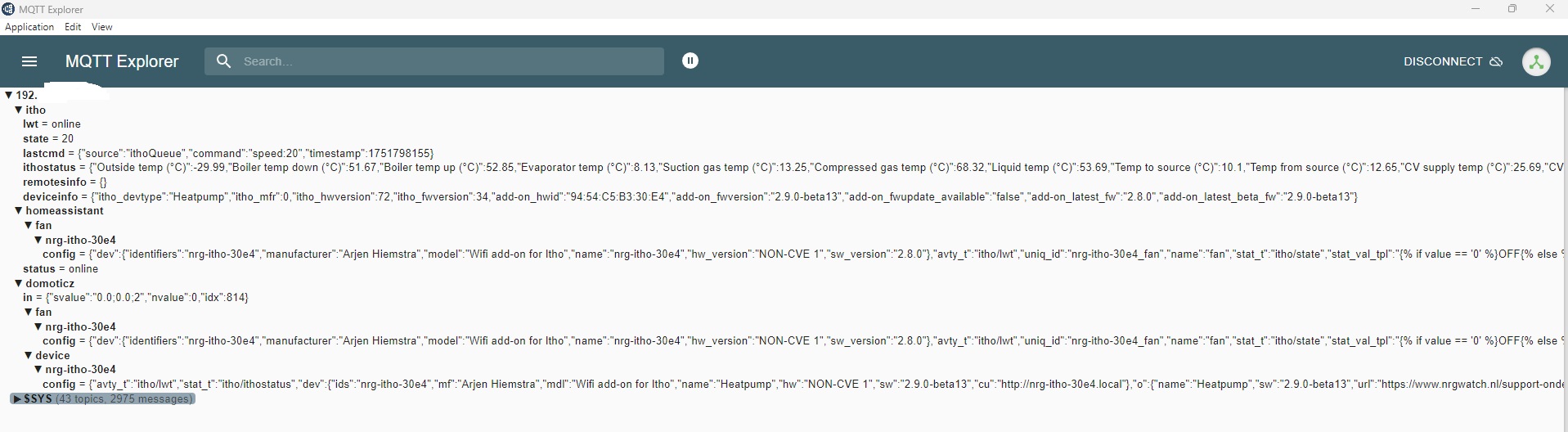

I am trying to connect a Itho heatpump to Domoticz. I am using (trying) to do this with MQTT. I do have a connection, Auto discover is creating a fan in Domoticz, no other devices. With MQTT explorer i can see some data, but does this data telling me that it is not possible in this way?

There is only a fan device config in the homeassistant topic so that should be correct.
I dont know where the config topic in the Domoticz topic is coming from but that seems to be a configuration error made by you.
I suspect in the Itho topic all the device states are shown and in the homeassistant topic all the device config are shown. Domoticz looks at the config topics to create devices. In the state topics the states of those devices are shown.
So it seems you miss some config topics in the homeassistant topic if you expect more devices should be created.
