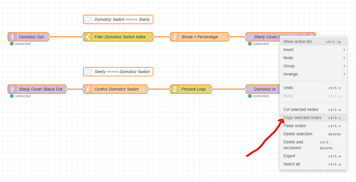

You have 2 streams, one from Domoticz to the Shelly.
This one needs only the Domoticz IDX number of the Domoticz Switch.
See the picture below and the "red arrow" in the "Switch" node, called "Filter Domoticz Switch Index"

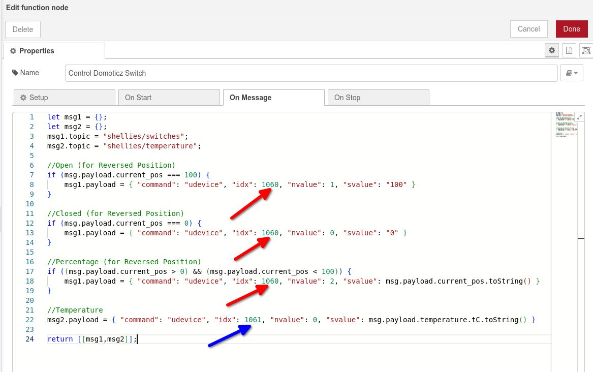

The other stream is from the Shelly to Domoticz This one needs the Domoticz IDX's in the "Function" node.
See the picture below and the "red arrows" in the "Function" node, called "Control Domoticz Switch" for the Domoticz switch
and the "blue arrow" for the Domoticz Temperature Sensor.

ok so I select the whole flow and give copy.
Then new FLOW and ctrl+V
Yes, or Select the nodes, you want to copy and then CTRL-C and CTRL-V

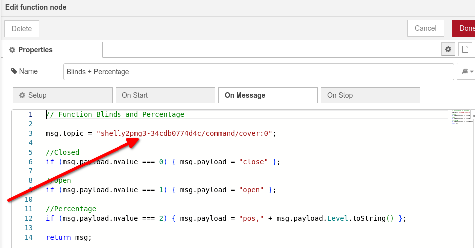

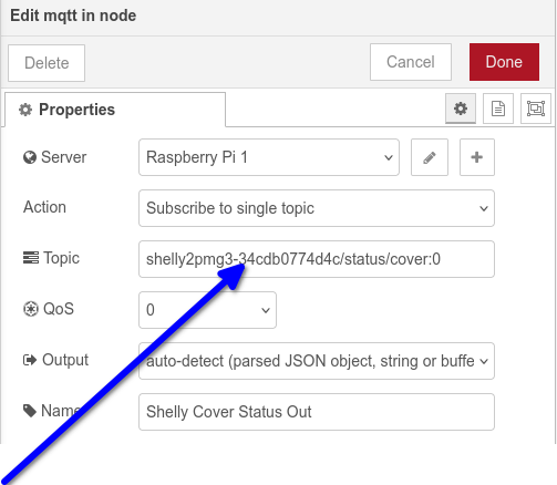

But okay,
In the upper stream from Domoticz to the Shelly, click on the Function node, called "Blinds + Percentage" and see below:
In the lower stream from Shelly to Domoticz, click on the MQTT Input node, called "Shelly Cover Status Out" and see below:
