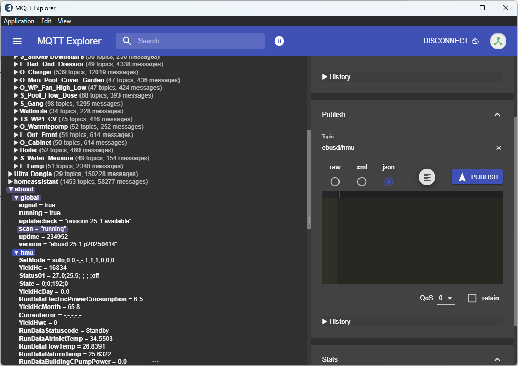

Sorry to bother you again, but I have a MQTT value that is not updating:
value in MQTT Explorer:
RunDataCompressorSpeed = {"value": {"value": 30}}
and a Mqtt file:
"RunDataCompressorSpeed": {
"topic": "ebusd/hmu/RunDataCompressorSpeed",
"type": "243", "subtype": "6", "switchtype": "0",
"mapping": {"item": "value/value"}
It just updated now, but it seems the frequency is not in line with the MQTT Explorer output. I did change the name, is that of influence?
and a Mqtt file:

I have solved the water sensor and light sensor!
I have one question remaining. I use the sensors in ebusd as sensors to contol that I still have a connection. These are booleans, which I cant read very well in domotics. I've tried nearly everthing but I can't work it out.
Mqttfile:
"T_Outside": {
"topic": "ebusd/Broadcast/Outsidetemp",
"type": "80", "subtype": "5", "switchtype": "0",
"mapping": {"item": ""}
"T_Living": {
"topic": "ebusd/ctlv2/Z1RoomTemp",
"MQTTrunning": {
"topic": "ebusd/global/running",
"type": "244", "subtype": "73", "switchtype": "0",
"mapping": {"item": "", "default": "0"}
"MQTTsignal": {
"topic": "ebusd/global/signal",
"mapping": {"item": "", "default": "0", "values": {"false": "0ff", "true" : "On"}}
"MQTT_Compressor": {
Mqttfile:
"T_Outside": {
"T_Living": {
"MQTTrunning": {
"MQTTsignal": {

Now what do I use in domoticz to read out that signal?
Further with the temperature readout i have a mqtt server that "switches" between:
Outsidetemp = {"value":{"value":30.125}}
and
Outsidetemp = 30.125
which needs "mapping" : {"item": {"value"/"value"}}
or "mapping" : {"item": ""}
I keep changing it .....
and

Both values are true, so I would expect them to be 100?
also have the two temperatures that need to be scripted to the readout temperatures ... I don't really have a clue how to start, I have programming skills, but they are very limited. I thought that MqttMapper made the output blocks in domoticz, but for instance I deleted the charger output thinking it would be created, but it wasn't
2025-06-13 17:19:14.020 MQTT mapper: Calling message handler 'onMessage' on 'module' type object.
2025-06-13 17:19:14.020 MQTT mapper: onMQTTPublish found ebusd/global/signal, Device 'MQTTsignal', message 'True'
2025-06-13 17:19:14.020 MQTT mapper: testValue="False" (str), readValue="True" (str)
2025-06-13 17:19:14.020 MQTT mapper: testValue="True" (str), readValue="True" (str)
2025-06-13 17:19:14.020 MQTT mapper: Setting MQTTsignal to 1/
2025-06-13 17:19:14.020 (MQTTsignal) Updating device from 1:'' to have values 1:''.
2025-06-13 17:19:14.022 MQTT mapper: Processing 'onMessageCallback' message
2025-06-13 17:19:14.022 MQTT mapper: Calling message handler 'onMessage' on 'module' type object.
2025-06-13 17:19:14.022 MQTT mapper: onMQTTPublish found ebusd/global/running, Device 'MQTTrunning', message 'True'
2025-06-13 17:19:14.022 MQTT mapper: testValue="False" (str), readValue="True" (str)
2025-06-13 17:19:14.022 MQTT mapper: testValue="True" (str), readValue="True" (str)
2025-06-13 17:19:14.022 MQTT mapper: Setting MQTTrunning to 1/
2025-06-13 17:19:14.022 (MQTTrunning) Updating device from 1:'' to have values 1:''.

I was just wondering how to get the values. The script must run within MqttMapper.
This is the current logging:
2025-06-21 17:22:10.925 MQTT mapper: Pushing 'onMessageCallback' on to queue
2025-06-21 17:22:10.925 MQTT mapper: Processing 'onMessageCallback' message
2025-06-21 17:22:10.925 MQTT mapper: Calling message handler 'onMessage' on 'module' type object.
2025-06-21 17:22:10.925 MQTT mapper: onMQTTPublish found ebusd/Broadcast/Outsidetemp, Device 'MQTT mapper - T_Outside', message '{'value': {'value': 30.375}}'
2025-06-21 17:22:10.926 MQTT mapper: Setting MQTT mapper - T_Outside to >{
2025-06-21 17:22:10.926 "value": {"value": 30.375}}<
2025-06-21 17:22:10.926 (MQTT mapper - T_Outside) Updating device from 0:'{
2025-06-21 17:22:10.926 "value": {"value": 30.375}}' to have values 0:'{
2025-06-21 17:22:10.926 "value": {"value": 30.375}}'.
so the value is 30.375, but it is set to 0, also within devices it is set to 0. So where do I make the script?

Are you sure device has been set to text ("type": "243", "subtype": "19", "switchtype": "0"), and device recreated ?
Could you check that "T_OutsideText" device is properly displayed into "Utility" tab?
hjzwiers
- Posts: 309
- Joined: Friday 12 January 2018 8:26
Re: Python Plugin: MqttMapper
I know have {"value": {"value": 30.375}} as an item in my list: thanks a lot.
Now the conversion never done that before
