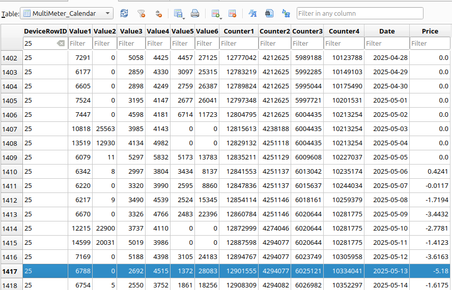

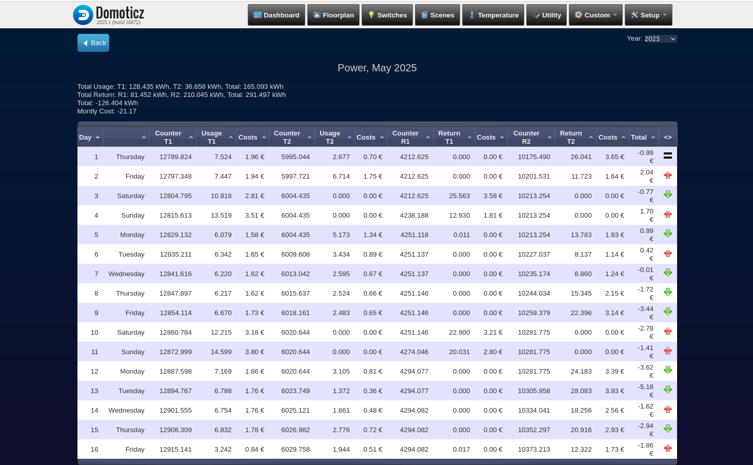

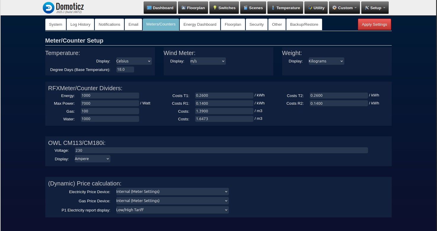

Walter I still have a problem with the cost calculation in domoticz 2025.1. The problem seems to be the total cost. The usage and return cost values are calculated correctly with right cost values from the meter/counter settings. However those values don't add up tto give the total-cost. I saw some of your remarks in an other post. There you suggested to set the price column of the multi_meter_calender table to zero. I did that and then the calcultion is right, but the next day the total cost in the report went wrong again. Any idea where I should look to get it right.?
Attached the report and meter settings screen dump

Can you give an example line where the 'Total' column is not correct? Maybe I missed something because of all these numbers in the table.
Are you using a dynamic contract (prices per hour), or have day/night tarrifs

Attached the screenschot of the report and multimeter_calander table ofn the13th of may. I use fixed costs set in the setttings (see above). Both (T1 and T2) set at 0.26 E/kwh and (R1 and R2) set at 0.14 E/kwh.
Therefore I expect :
The costs:
T1= 6.788* 0.26 = 1.76488 Euro
T2= 1.372* 0.26 = 0.35672 Euro
R1= 0 *0.14 = 0 Euro
R2=28.083* 0.14= 3.93162 Euro
Total= (1.76488 0+0.35672) -( 0 +3.93162)= -1.81002 Euro
Therefore the cost of the T1,T2,R1,and R2 are calculated correctly but the Total is wrong. (And this is used in the Garphs as well) and I think this miscalculation also affects the energy dashboard...
Both the Report and the the Table gives -5.18 Euro. Therefore I assume only one (T1) price (0.26) is used to calculate the total.
n.l --> (6,788+1,372 − 28,083)×0,26= - 5.18 Euro
Hope this gives some better info to you ?.

I searched lots of forum posts, but I still can't find the correct explanation for the total cost of a fixed cost contract.
Based on the figures above, and with 100% "salderen" still in 2026, the calculation is correct in my opinion:
If both (T1 and T2) set at 0.26 Euro/kWh and (R1 and R2) set at 0.14 Euro/kWh I expect:
+ T1= 6.788 * 0.26 = 1.76488 Euro
+ T2= 1.372 * 0.26 = 0.35672 Euro
- R1= 0 * 0.26 = 0 Euro (100% salderen)
- R2= 28.083 * 0.26 = 7.3016 Euro (100% salderen)
Total Cost = (1.76488 + 0.35672) - (0 + 7.3016) = -5.18 Euro, so this is correct for Total Cost in the table and it doesn't use Costs R1 and Costs R2 in the calculation.
But what will happen in 2027 when I have 0% "salderen"?
I still will have my import Costs, e.g.:
But now I get a benefit / small amount paid for every returned kWh (R1, R2), e.g. 0.02 Euro/kWh.
- R1= 0 * 0.02 = 0 Euro (Netto Terugleververgoeding - Terugleverkosten)
- R2= 28.083 * 0.02 = 0.5617 Euro (Netto Terugleververgoeding - Terugleverkosten)
Total Cost = (1.76488 + 0.35672) - (0 + 0.5617) = 1.56 Euro
So this calculation needs Costs R1 and Costs R2 for the calculation, and you can even debate if we should change or keep the naming, as in 2027 it's not a cost but a benefit. In Setup - Settings - Meters/Counters, should it be e.g. "Costs R1" = -0.02 or "Benefit R1" = 0.02 ?
Any opinions on this?

Domoticz version: 2026.3
Re: Energy Costs Calculator
Why should the calculation change? You only have to fill in a different cost/tariff for R1 and R2 (0.02 instead of 0.26). You can do that in the Domoticz settings on jan 1 2027.
Edit: And enable Price calculation by setting the electricity price device to Internal (Meter Settings). On the moment you change the cost/tariff settings it will calculate with the new tariffs. If you do not do that Domoticz will use the new tariffs also for history measurements. So enable this as soon as possible.
https://wiki.domoticz.com/Application_S ... alculation

True, that should work indeed. Thanks for the help.
