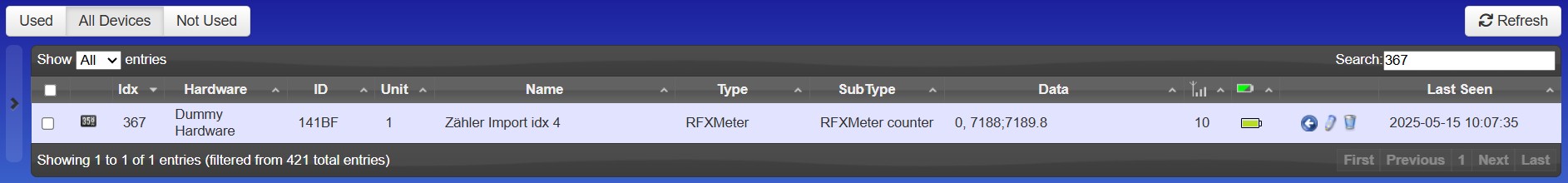

Since the update to 2025.1, a certain dummy hardware device has disappeared and now only appears occasionally for a short time.
It is an energy counter / meter which gets the data from my electric meter via an infrared sensor with Tasmoa ("Hichi" infrared head). It worked perfect since the update.
What I have found out is this:
When I open the device list with the filter "all", it is not shown.
Then I switch to "unused" and reload the list. Of course it doesn't appear, as it is a used device.
Then I switch back to "all" and now the device is shown and obviously receives the data. See Screenshot.
After another reload it is away again and only appears shortly again with above mentioned procedure.
In the tab of "utilities" it never appears.

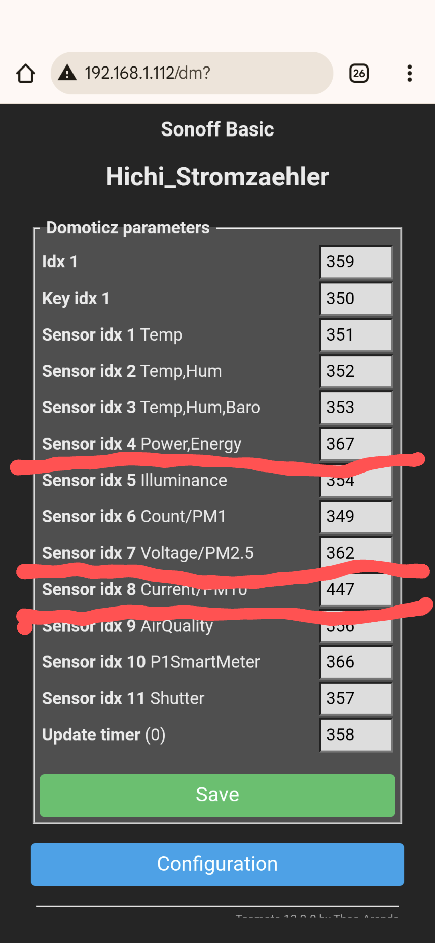

The dummy device is updated via a Tasmota device ("Hichi" infraread reading d
head attached to the general electric meter). I simply type in the Domoticz IDX under the Tasmota item " Configure Domoticz). I don't define any parameters.
See Screenshot.
Tasmota IDX 4 gets Domoticz IDX 367 and shows the counted imported energy in kWh.

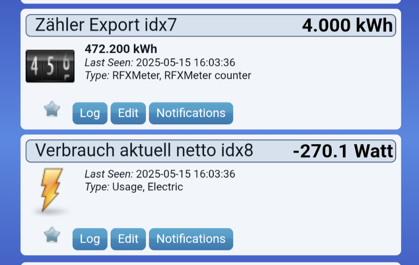

Tasmota IDX 7 gets Domoticz IDX 362 and shows the counted exported energie in kWh (the Tasmota Label "Voltage ..." is not correct here. This Device still works as it did before the Domoticz update.
Tasmota IDX 8 gets Domoticz IDX 447 and shows the current power in W. This Device also still works as it did before the Domoticz update
(The other Tasmota idxs are not delivering any values. The corresponding Domoticz idxs are just the rest of the testing with test devices to see if something is delivered here)
