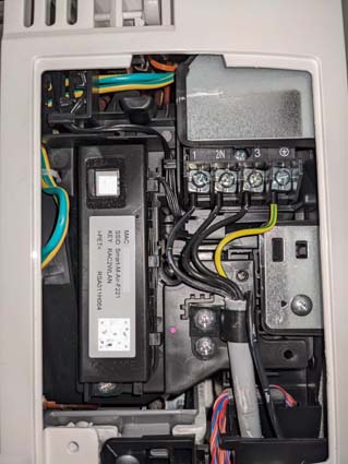

Answer: Yes I have a brandnew Mitsubishi HI with a works WiFi module. (See below)Do you have the "WF RAC" option? (new models)
Answer: I gave the aircon a reserved ip adres in my router so it won't change and double checked that it is the right one and yes I can operate it with the 'Smart M-Air" application. That works but i don't like that app.If yes, did you enter the correct IP address? And this also assumes you can operate the aircon with the 'Smart M Air' application
Who can I talk to about the functionality of this plugin?
