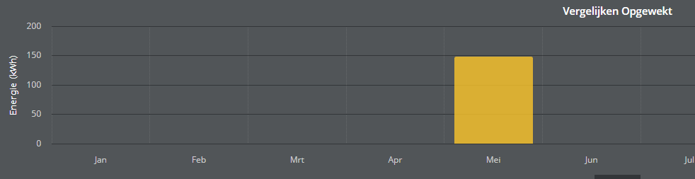

Hi Guys,
I've a strange daily value which i don't see in the reports or logs
2025-05-25 20_00_05-Domoticz - Overige.png (13.73 KiB) Viewed 6004 times
2025-05-25 20_03_47-Domoticz - Devices_891_Log.png (7.76 KiB) Viewed 6003 times
Any idea where this is coming from or how to correct?
Posts: 7024
Domoticz version: 2026.3
Re: SolarEdge via LAN interface
I have seen this reported more before. Seems to be an error on the SolarEdge side suddenly reporting strange values.

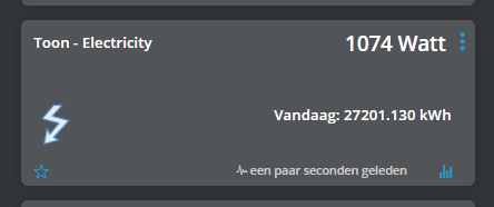

Are you sure ?
My Toon is also givin a large number and this is readingout the P1
2025-05-31 08_50_43-Domoticz - Overige.png (8.73 KiB) Viewed 5848 times

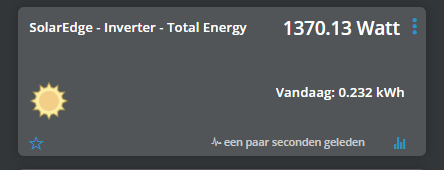

And i installed the plugin on an old Version: 2023.2 (build 15462)
Which looks correct

madpatrick wrote: Saturday 31 May 2025 8:22 Are you sure ?
Which looks correct
Isn't this the total production of the PV installation? (Labeled wrong)
