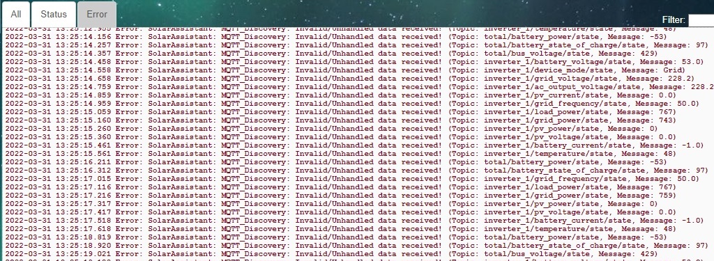

I have a inverter connected to Solar-Assistant and they released mqtt support ( https://solar-assistant.io/help/integration/mqtt )
Have sett it up as i think it works, but get the messages under.
Is it something i can do, someone want to nudge me in the right direction? :?

Solved some of them, did not have Auto Discovery Prefix to homeassistant.
But the ones containing battery information did not get created:
total/battery_power/state
total/battery_state_of_charge/state
Inverter_1/battery_voltage/state
Inverter_1/battery_current/state
And the temperature sender from the inverter is reporting low battery, but does not have battery..
Any idea where/how i can edit and add the missing devices?

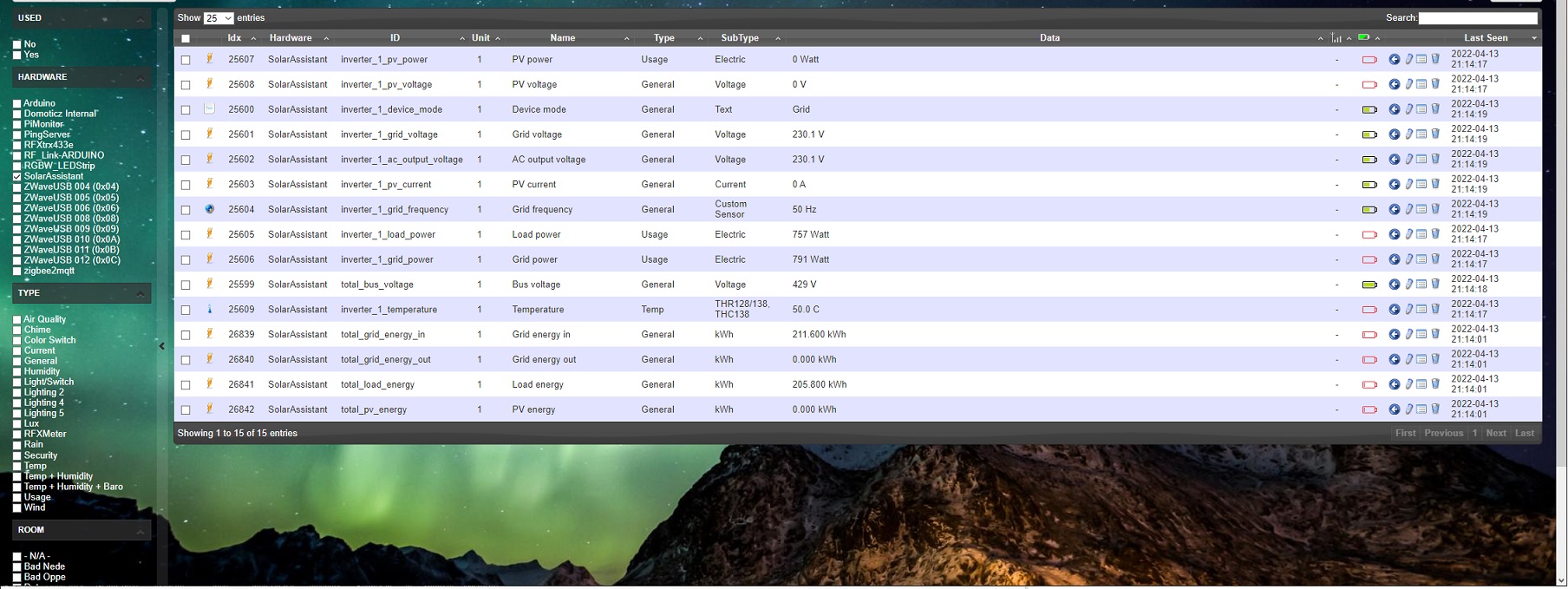

Updated
Here is what sensors i get, log and mqtt info.
Think the solar unit is made for home assistant
octy
Posts: 9
Joined: Monday 01 February 2021 17:21
Re: MQTT solar-assistant
Post by octy »
Some of the battery sensors does not show in domoticz, and some of the sensors in the inverter randomly says its low on battery.
