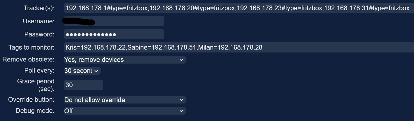

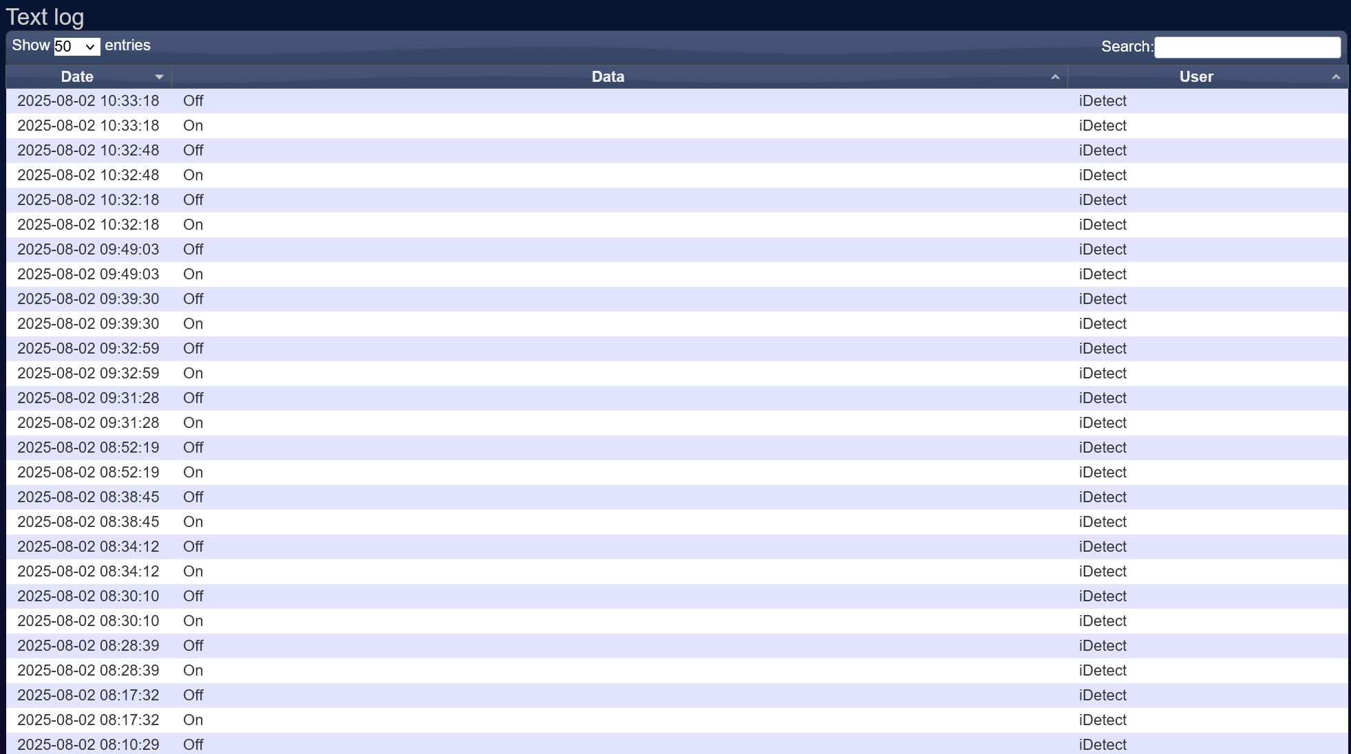

I have a problem with the idetect presence detection from my fritzbox 6890 LTE.
See log This is my idetect setup with fritzbox 3 repeaters , and the fritzbox itself. If someone know what to do , please let me know it.
Thanks.
Thanks.

In my mesh setup I only need te query the (Fritz 4060) mesh master

Sorry , no luck. I have tried different combinations with the trackers.EscApe wrote: Saturday 02 August 2025 13:31 In my mesh setup I only need te query the (Fritz 4060) mesh master
Before I had a fritzbox 7590AX and that worked well.
Now I've been looking to gpslogger for presence detection.
