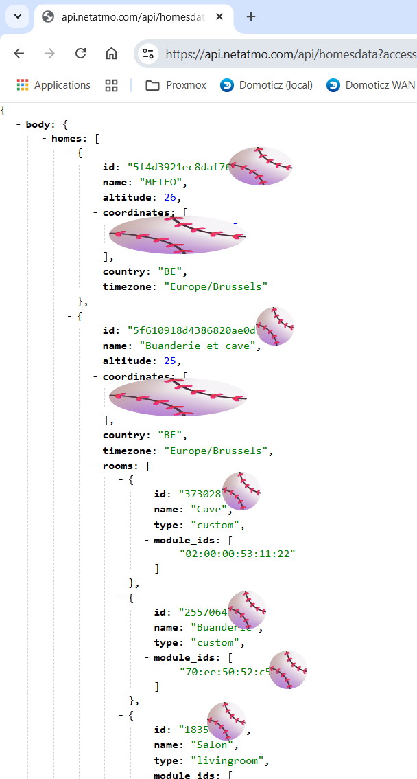

Re: Netatmo authentication changes Oct 2022
You can run this test to verify if the API is working.
In a browser like Chrome, type this line:
https://api.netatmo.com/api/homesdata?access_token=xyz
Make sure to replace xyz with your valid access_token (not the refresh_token), without single or double quotes.
You should receive a JSON response beginning with: {"body":{"homes":[
jcb2
- Posts: 44
- Joined: Wednesday 04 January 2023 7:30
- Location: Belgium
Yes I have one result :
I'm not surprised. You're receiving a json file because the API is working, which I've been reporting since March 20th. The URL query bug only lasted a few hours. The problem lies elsewhere. You need to look into the connection with the third-party application (on the Netatmo side) or the Domoticz integration (on the Domoticz side). I can't help you further because I don't use Domoticz; all my home automation is managed with my own scripts, Netatmo, Philips Hue, Sonoff and more.
