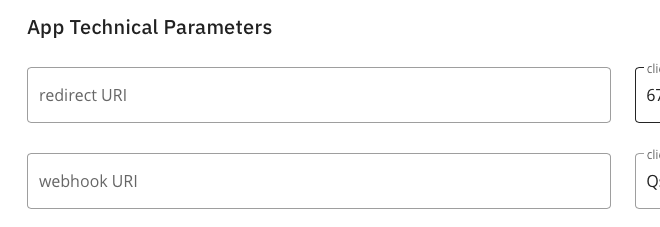

in the portal dev.netatmo.com my app looks like this.
Login 0.png (18.99 KiB) Viewed 1449 times
when I stop the Netatmo service for 20 minutes
and then start the login works for me.
I recommend you renew the credentials then go to Hardware and put in client and secret
select the correct scopes for your device
Press login
you will see the pop-up and login / accept
I hope you can get it to work.
kind regards

Redirect_URI and Webhook URI in Netatmo APP should be empty (not containing ""). See example in post viewtopic.php?p=324524#p324524
Then follow in Domoticz the procedure as shown in post viewtopic.php?p=324480#p324480
