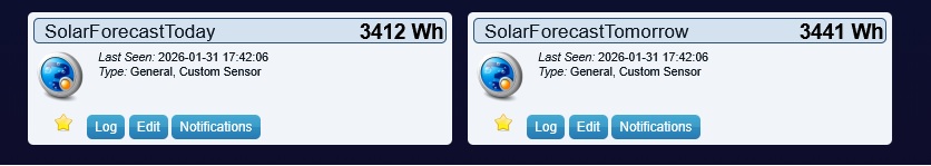

JanJaap
Posts: 244
Joined: Thursday 12 October 2017 20:46
Domoticz version: Dev
Location: the Netherlands
Re: solar power prediction
Post by JanJaap »
ok I can fetch data, so far so good. As I never use the dzEvents I'm a bit puzzled to how the sensor update works. Is the 24 hr forecast counter updated per hour? So only one hour form now? Or is it always giving 24 hrs ahead but all hours being updated as time passes?
See first part: JanJaapKo/SolarForecast
RPi 3, Domoticz dev version, Aeon ZWave stick (with a whole bunch of slaves), Zigbee using Zigbee2MQTT, Nest thermo, P1 smart meter on RPi Zero

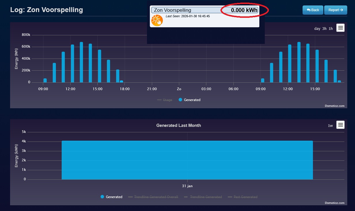

eatme1972
Joined: Friday 30 January 2026 16:52
Post by eatme1972 »
I installed the Solar Forecast plugin from Jan-Jaap Kostelijk in my Domoticz, but I can not fill in my location anywhere. The counter also stays on 0 KWH.
What am i missing?
JanJaap
Posts: 244
Post by JanJaap »
The location is taken from your Domoticz settings. Then fill out all mandatory settings in the plugin hardware page. And then I think you need to wait for the evening as i remember only polling then to avoid rate limits.
If it then still doesnt do anything i need screenshot of HW config and debug logging.
Oh and the values only appear in the logging of the device, as there is never an actual value.
Thanks JanJaap,
It makes sense to use Domoticz location, I didn't think of that.
I still see "0.00 KwH" in my dashboard. When I open it, I see values.
My goal is to switch on a boiler for x hrs when the solar prediction > 15 KwH.
I have solar panels on east and west, so I make 2 solar forecast hardware/devices and add them up.
Can I do this with the plugin?
Last edited by eatme1972 on Saturday 31 January 2026 13:52, edited 1 time in total.

Update :
Using the dzvents script from psubiaco and claude.ai, I created a script that adds up the 24-hour yield for today and tomorrow from my east and west panels and displays this.
Now to see over the coming year if it's reasonably accurate :)
