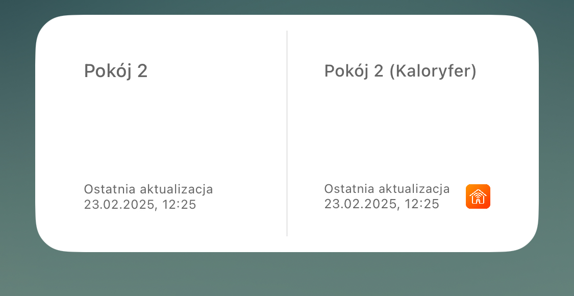

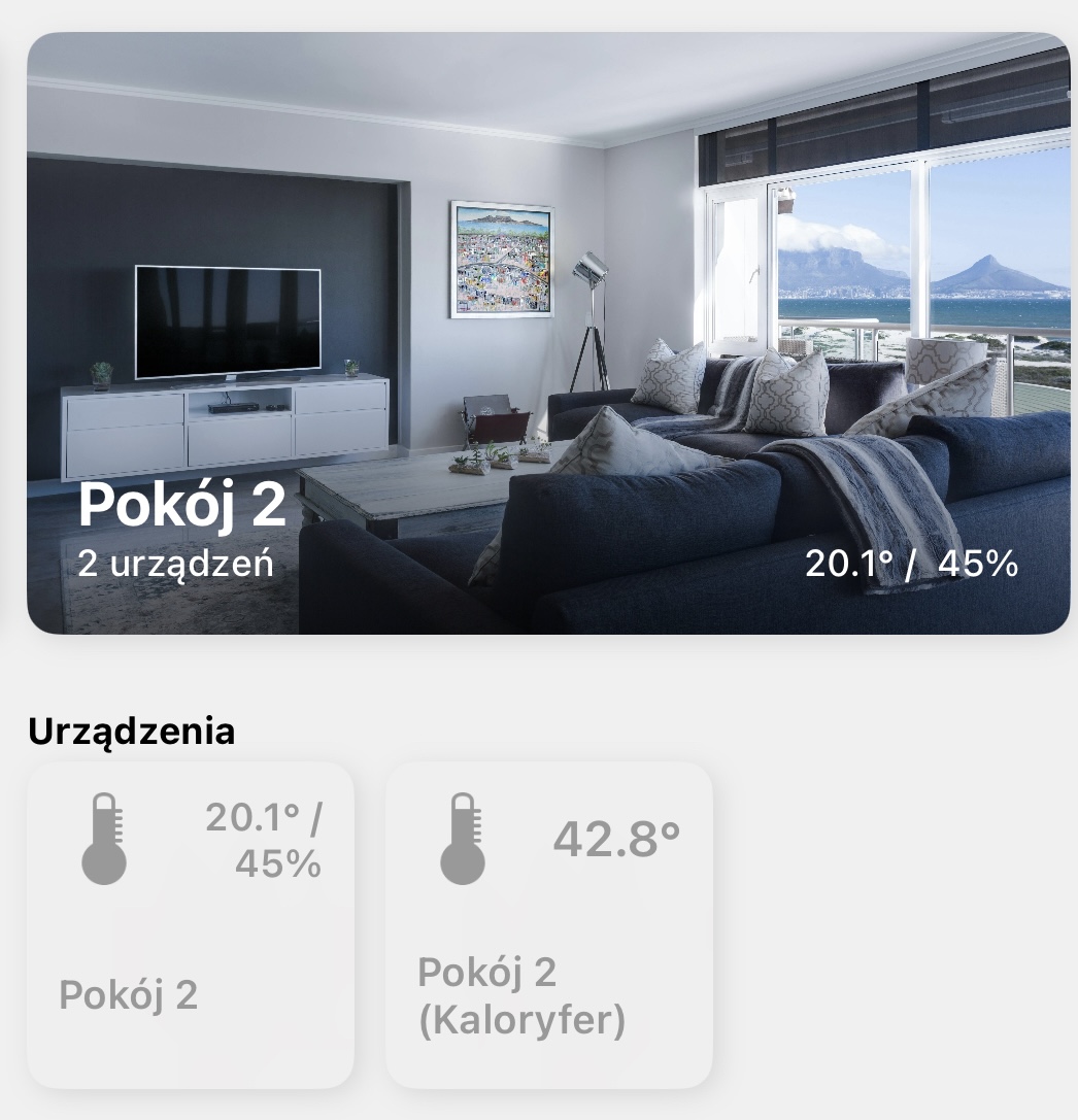

Dose any of you have a problem with the data displayed in widget of Pilot ?
I don’t see the value of my sensors in widget, when the sensors are assigned to any of my “Rooms”. When I remove the sensor from the “Room”, the data are displayed correctly in widget.
I use the last version of Domoticz 2024.7 and Pilot in version 2025.2.2 on IOS 18.3.1
