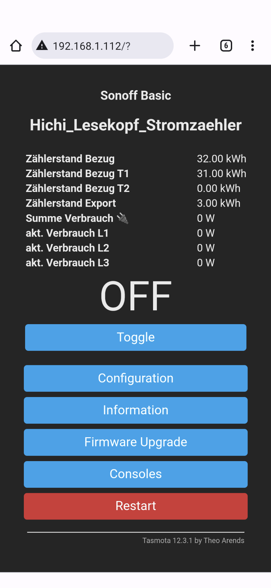

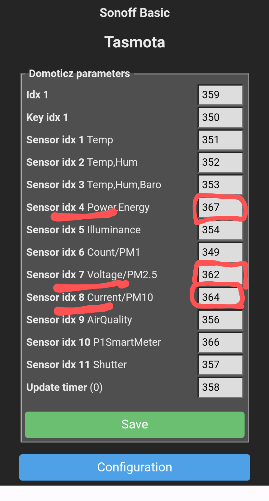

Using the “Hichi IR reading head” I can see some of the values of my electricity meter displayed on the Tasmota interface. I can also get one value of this transferred to Domoticz by entering the idx of the device in Domoticz with the sensor idx4 from Tasmota. But how can I get the other values in Domoticz? I tried the available sensors idx 1 to 11, but nothing works.

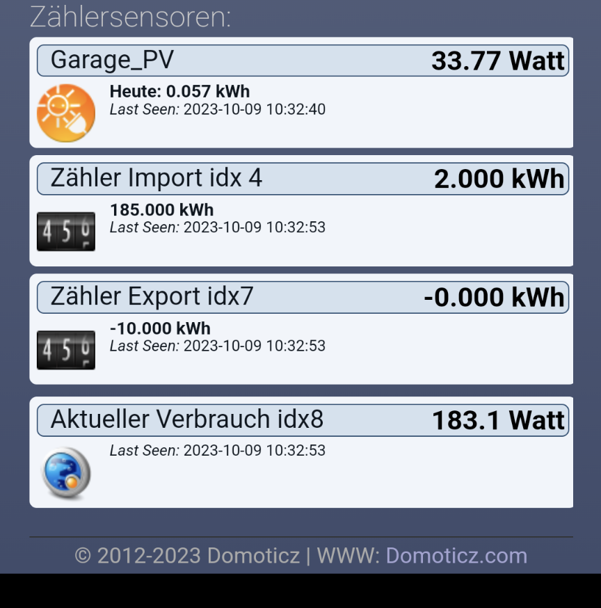

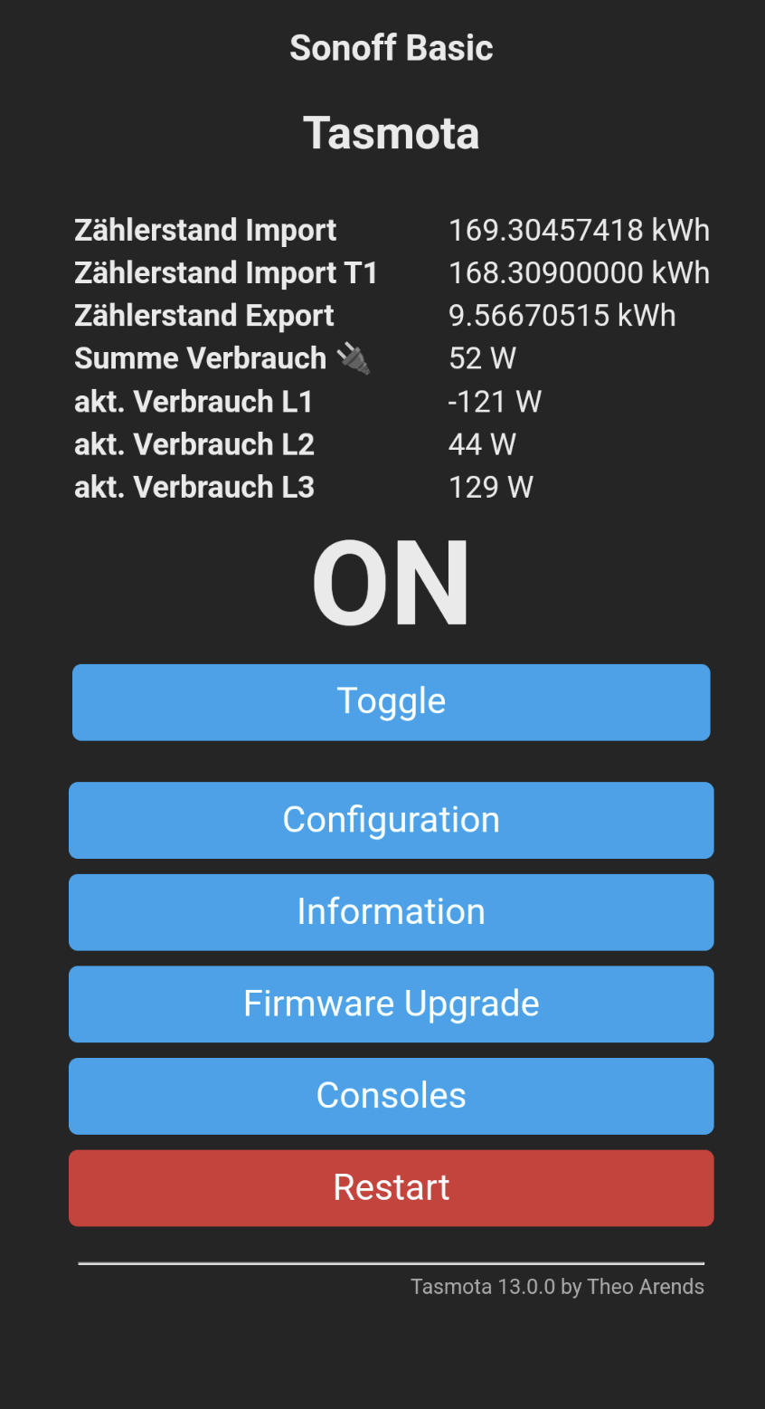

I have now received and entered the PIN for my electricity meter. Now the current power consumption is also displayed - next to the two meter readings. To get these values in Domoticz you have to enter the corresponding devices for idx4, idx7 and idx8. The other sensors do not transmit any data, I tested that.
