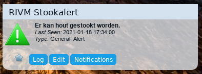

This application is only suitable for Dutch users

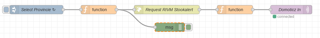

This application uses a Node Red solution, which polls an undocumented API of https://www.rivm.nl/stookalert from RIVM and sends its value with MQTT to a virtual Domoticz sensor.
Especially in the winter period it is quite popular to burn wood in your fireplace, pellet stove or use a fire pit.
Sometimes the weather conditions are very bad, like wind still weather or fog, and that will hinder your neighbours, because the smoke lingers.
RIVM maintains a website, where you can see in which province a smoke alert is given. (https://www.rivm.nl/stookalert)
Normally the smoke alert is given at around 12:00 h at noon and is valid for the afternoon and the evening of the day.
This flow checks an undocumented api (at least I could not find it at the RIVM site) hourly and sends a text to a virtual alert sensor.
Usage:
Insert in the Inject node, called "Select Provincie" your preferred province as a string to msg.topic.
In the function node, you have to insert your Domoticz IDX number of the created virtual "Alert" Sensor at line 4.
At line 6 and 7, you can change the texts, you want to see in the virtual "Alert" sensor.

For the colors of the "Alert" Sensor I use green in case the weather conditions are good enough to burn wood and orange in case a wood fire is not recommended. However, it is not forbidden.
Please find the flow below:
[{"id":"9733298a.68c738","type":"tab","label":"Stookalert","disabled":false,"info":""},{"id":"f4c7f323.283a6","type":"function","z":"9733298a.68c738","name":"","func":"// Stookalert (only available in The Netherlands)\n\n// Insert Domoticz IDX number of virtual \"Alert\" sensor below.\nvar idx = 483;\n\nvar stookalert = \"De weersomstandigheden zijn de komende uren ongunstig, zodat het afgeraden wordt om hout te stoken.\";\nvar no_stookalert = \"Er kan hout gestookt worden.\";\n\n    switch (msg.topic) {\n\n    case \"Groningen\":\n        if (msg.payload[0].waarde === 0) {\n            msg.payload = {\"command\":\"udevice\",\"idx\":idx,\"nvalue\":1,\"svalue\":no_stookalert};\n        } else {\n            msg.payload = {\"command\":\"udevice\",\"idx\":idx,\"nvalue\":3,\"svalue\":stookalert};\n        }\n    break;\n\n    case \"Friesland\":\n        if (msg.payload[1].waarde === 0) {\n            msg.payload = {\"command\":\"udevice\",\"idx\":idx,\"nvalue\":1,\"svalue\":no_stookalert};\n        } else {\n            msg.payload = {\"command\":\"udevice\",\"idx\":idx,\"nvalue\":3,\"svalue\":stookalert};\n        }\n    break;\n\n    case \"Drenthe\":\n        if (msg.payload[2].waarde === 0) {\n            msg.payload = {\"command\":\"udevice\",\"idx\":idx,\"nvalue\":1,\"svalue\":no_stookalert};\n        } else {\n            msg.payload = {\"command\":\"udevice\",\"idx\":idx,\"nvalue\":3,\"svalue\":stookalert};\n        }\n    break;\n\n    case \"Overijssel\":\n        if (msg.payload[3].waarde === 0) {\n            msg.payload = {\"command\":\"udevice\",\"idx\":idx,\"nvalue\":1,\"svalue\":no_stookalert};\n        } else {\n            msg.payload = {\"command\":\"udevice\",\"idx\":idx,\"nvalue\":3,\"svalue\":stookalert};\n        }\n    break;\n    \n    case \"Gelderland\":\n        if (msg.payload[4].waarde === 0) {\n            msg.payload = {\"command\":\"udevice\",\"idx\":idx,\"nvalue\":1,\"svalue\":no_stookalert};\n        } else {\n            msg.payload = {\"command\":\"udevice\",\"idx\":idx,\"nvalue\":3,\"svalue\":stookalert};\n        }\n    break;\n\n    case \"Utrecht\":\n        if (msg.payload[5].waarde === 0) {\n            msg.payload = {\"command\":\"udevice\",\"idx\":idx,\"nvalue\":1,\"svalue\":no_stookalert};\n        } else {\n            msg.payload = {\"command\":\"udevice\",\"idx\":idx,\"nvalue\":3,\"svalue\":stookalert};\n        }\n    break;\n\n    case \"Noord-Holland\":\n        if (msg.payload[6].waarde === 0) {\n            msg.payload = {\"command\":\"udevice\",\"idx\":idx,\"nvalue\":1,\"svalue\":no_stookalert};\n        } else {\n            msg.payload = {\"command\":\"udevice\",\"idx\":idx,\"nvalue\":3,\"svalue\":stookalert};\n        }\n    break;\n\n    case \"Zuid-Holland\":\n        if (msg.payload[7].waarde === 0) {\n            msg.payload = {\"command\":\"udevice\",\"idx\":idx,\"nvalue\":1,\"svalue\":no_stookalert};\n        } else {\n            msg.payload = {\"command\":\"udevice\",\"idx\":idx,\"nvalue\":3,\"svalue\":stookalert};\n        }\n    break;\n\n    case \"Zeeland\":\n        if (msg.payload[8].waarde === 0) {\n            msg.payload = {\"command\":\"udevice\",\"idx\":idx,\"nvalue\":1,\"svalue\":no_stookalert};\n        } else {\n            msg.payload = {\"command\":\"udevice\",\"idx\":idx,\"nvalue\":3,\"svalue\":stookalert};\n        }\n    break;\n\n    case \"Noord-Brabant\":\n        if (msg.payload[9].waarde === 0) {\n            msg.payload = {\"command\":\"udevice\",\"idx\":idx,\"nvalue\":1,\"svalue\":no_stookalert};\n        } else {\n            msg.payload = {\"command\":\"udevice\",\"idx\":idx,\"nvalue\":3,\"svalue\":stookalert};\n        }\n    break;\n\n    case \"Limburg\":\n        if (msg.payload[10].waarde === 0) {\n            msg.payload = {\"command\":\"udevice\",\"idx\":idx,\"nvalue\":1,\"svalue\":no_stookalert};\n        } else {\n            msg.payload = {\"command\":\"udevice\",\"idx\":idx,\"nvalue\":3,\"svalue\":stookalert};\n        }\n    break;\n\n    case \"Flevoland\":\n        if (msg.payload[11].waarde === 0) {\n            msg.payload = {\"command\":\"udevice\",\"idx\":idx,\"nvalue\":1,\"svalue\":no_stookalert};\n        } else {\n            msg.payload = {\"command\":\"udevice\",\"idx\":idx,\"nvalue\":3,\"svalue\":stookalert};\n        }\n    break;\n}\n\nreturn msg;","outputs":1,"noerr":0,"initialize":"","finalize":"","x":840,"y":80,"wires":[["9ada7858.066e08"]]},{"id":"5fd59141.006298","type":"inject","z":"9733298a.68c738","name":"Select Provincie","props":[{"p":"topic","vt":"str"},{"p":"payload"}],"repeat":"3600","crontab":"","once":true,"onceDelay":0.1,"topic":"Gelderland","payload":"","payloadType":"date","x":170,"y":80,"wires":[["13f74ed3.21c921"]]},{"id":"f3a46cd4.084518","type":"http request","z":"9733298a.68c738","name":"Request RIVM Stookalert","method":"GET","ret":"obj","paytoqs":"ignore","url":"","tls":"","persist":false,"proxy":"","authType":"","x":610,"y":80,"wires":[["f4c7f323.283a6"]]},{"id":"13f74ed3.21c921","type":"function","z":"9733298a.68c738","name":"","func":"msg.url = \"https://www.rivm.nl/media/lml/stookalert/stookalert_\" + ((new Date()).toISOString()).substring(0,4) + ((new Date()).toISOString()).substring(5,7) + ((new Date()).toISOString()).substring(8,10) + \".json\";\nreturn msg;","outputs":1,"noerr":0,"initialize":"","finalize":"","x":380,"y":80,"wires":[["f3a46cd4.084518"]]},{"id":"9ada7858.066e08","type":"mqtt out","z":"9733298a.68c738","name":"Domoticz In","topic":"domoticz/in","qos":"0","retain":"false","broker":"8591549f.77809","x":1030,"y":80,"wires":[]},{"id":"8591549f.77809","type":"mqtt-broker","name":"Jonas_MQTT_Server","broker":"192.168.10.24","port":"1883","clientid":"","usetls":false,"compatmode":true,"keepalive":"60","cleansession":true,"birthTopic":"","birthQos":"0","birthPayload":"","closeTopic":"","closeQos":"0","closePayload":"","willTopic":"","willQos":"0","willPayload":""}]

Hello @EddyG,
You wrote:
And the output of the first function is: 1610992303392
That is not a problem. What you see is the Unix timestamp.
This time stamp is not used.
The first Function node uses this timestamp to extract the date. This date is used in the URL.
msg.url = "https://www.rivm.nl/media/lml/stookalert/stookalert_" + ((new Date()).toISOString()).substring(0,4) + ((new Date()).toISOString()).substring(5,7) + ((new Date()).toISOString()).substring(8,10) + ".json";
return msg;
Check the contents of the first Function node with the above string.
If you connect a Debug node after the first "Function" node and look to the complete message object, you should see:

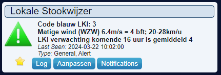

However, the RIVM report concerns the entire province, where there may be large local differences.
So, in addition to this, I have therefore created my own 'Lokale Stookwijzer'.
Based on 'Air Quality Index' (Luchtkwaliteitsindex - LKI) for the entered postal code and the local wind speed (from Buienradar) with a calculation according to the Dutch Informatiepunt leefomgeving.
It also provides a forecast for the average expected air quality index.
If there is interest, I am willing to share it in a separate post.

I am interested in your other script as well. It has indeed more information and specific for the address!
I looked at the json result and in my opinion the 'lookup' request results returns a bit to much information for a public site ;)
Maybe you could post it here as it is still about the Stoke-Alert? Other topic is great too!
