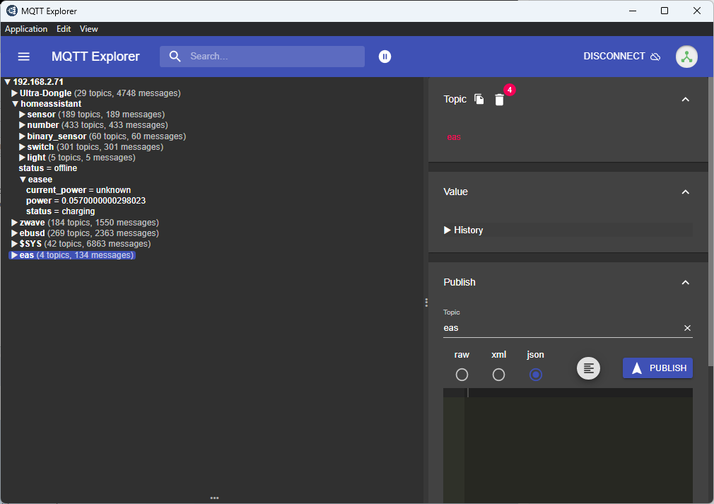

I got this error in the logging:
Status: Warning: Expecting svalue with at least 1 elements separated by semicolon, 0 elements received (""), notification not sent (Hardware: 31 - MQTT mapper, ID: homeassistant/easee/power, Unit: 2, Type: F3 - General, SubType: 29 - kWh)
now what do I need to change lol
Screenshot 2025-03-10 154526.png (55.37 KiB) Viewed 4008 times
FlyingDomotic
Posts: 475
Re: Python Plugin: MqttMapper
Post by FlyingDomotic »
Very strange... Looks like a configuration error, where homeassistant topic was given instead of "real" one (like "eas" or perhaps none)
Giving key name (easee), would it be possible to have a look at "eas" root topic (the one with 4 topics and 134 messages) ?

I moved the meassage to eas:
"MQTTsignal": {
"topic": "eas/easee/power",
"type": "243", "subtype": "29", "switchtype": "0",
"mapping": {"item": "values/value","multiplier": 1000}
I still get the same error message:
2025-03-11 08:43:38.304 Status: Warning: Expecting svalue with at least 1 elements separated by semicolon, 0 elements received (""), notification not sent (Hardware: 31 - MQTT mapper, ID: eas/easee/power, Unit: 7, Type: F3 - General, SubType: 29 - kWh)
So I think it is something wrong with the MQTTsignal, i changed it back to homeassistant, and I got this meassage
2025-03-11 09:48:31.733 MQTT mapper: onMQTTPublish found homeassistant/easee/power, Device 'MQTT mapper - Car charge', message '5.0019998550415'
2025-03-11 09:48:31.733 Error: MQTT mapper: Can't find >values/value< in >5.0019998550415<
2025-03-11 09:48:31.733 MQTT mapper: Setting MQTT mapper - Car charge to ><
2025-03-11 09:48:31.733 (MQTT mapper - Car charge) Updating device from 0:'' to have values 0:''.
So mqttmapper can find the value, but there is someting wrong with the displaying
"MQTTsignal": {
"topic": "homeassistant/easee/power",

Would it be possible to get "eas/easee/power" full content?
Concerning the error, it indicates that this kind of device (kWh counter) needs a value, while sent data only contents "" (meaning that value was not found or empty).
With "eas/easee/power" content, I'll help finding the right item.

hjzwiers wrote: Tuesday 11 March 2025 9:55 how do i get "full content"
I was also updating my previous message :-)
In mqtt explorer unfold to folder eas/easee/power
Select the power folder and copy the message/value (not a screenshot!). There is a copy value icon on the top right when the power topic is selected. See for a reference the Wiki for reporting MQTT AD issues https://wiki.domoticz.com/MQTT_AD_Repor ... nd_payload

Topic: homeassistant/easee/power
Value: 0.0
Value : 5.00899982452393
I can display a chart of the values, i just show two to prove that mqtt is showing them fine. Is this what you meant?

I keep getting
2025-03-11 10:27:48.926 Error: MQTT mapper: Can't find >value/watt< in >5.02199983596802<
MQTT sees the value, only can't use it ?
