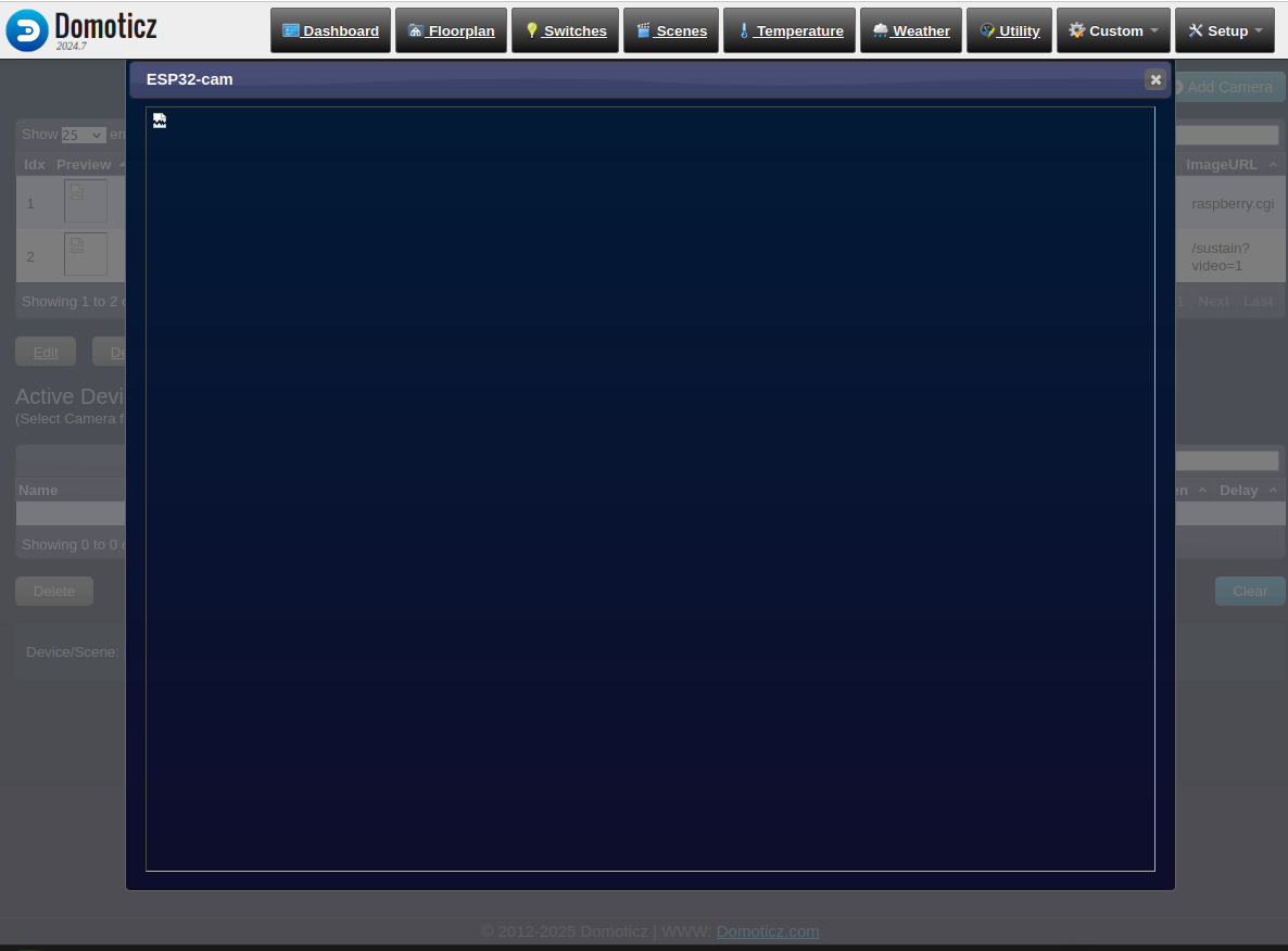

I am struggling to get the live stream of an ESP32-cam into domoticz. I've installed the application ESP32-CAM_MJPEG2SD into the board, and according with the documentation the url ESP32-camIPADDRESS:80//sustain?video=1 returns a live stream, which I have confirmed to work in my web browser, but when set up in domoticz I get only a blue screen
This is how it is set up
Thanks in advance for any help.

You do not need to enter the url of the stream but the url of the screenshot file (eg jpeg, png)
https://wiki.domoticz.com/Camera_Setup# ... o_Domoticz
Edit: according https://github.com/s60sc/ESP32-CAM_MJPEG2SD/issues/449 the snapshot link is
app_ip/control?still=1

Thanks for the help, @waltervl. It works!
Actually there was another issue, in that the IP address was missing a .1. between the 168 and 191.

So it was only the IP adress that was wrong or also the imageURL had to be changed?

Both the IP address and the imageURL were wrong/had to be changed.
