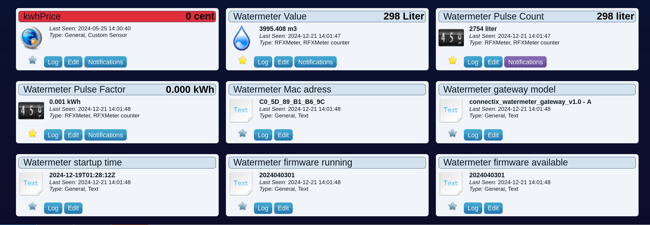

I just installed 'Watermeter Gateway' : a wifi device which 'sticks' on the watermeter and counts the pulses.
After some fiddling I got this working Image
I would like to get a notification( Pushover and email) when the water usage is above , say 8 liters/minute.
