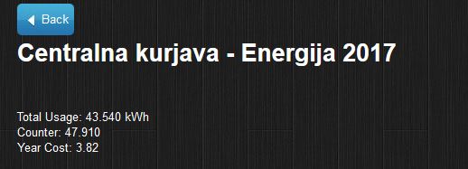

In addition to my previous post.
I did calculation based on Domoticz info about usage and cost (screenshot) and figure out that costs are calculated using only T1...

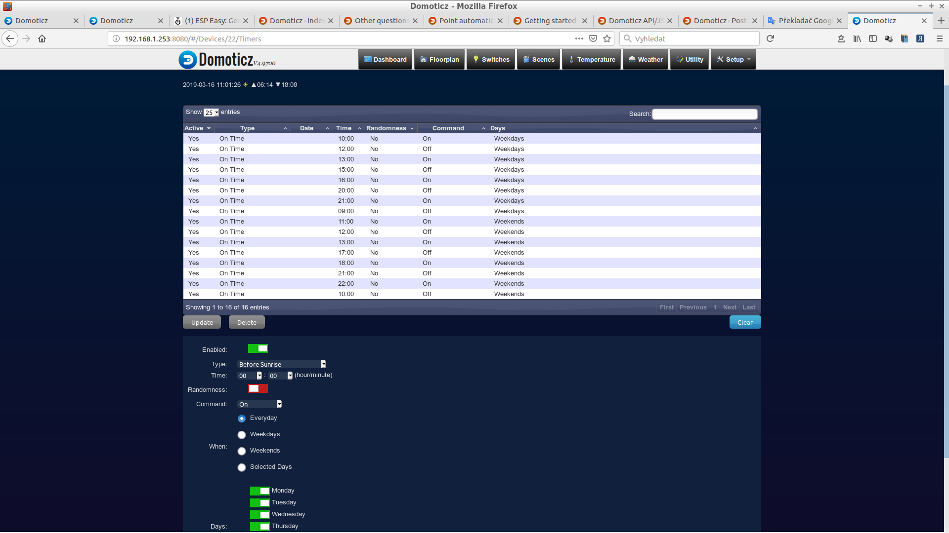

I think it's not such a difficult task.
Use the Electricity dummy P1 smart meter.
Then you must specify that the T1 or T2 tariff is currently running.
By LED on your electricity meter or use time plan for normal switch like me if your energy distributor use fixed times:
( I am sending this status to my sensor node )
Then your sensor must send USAGE1 or USAGE2 according current tarif.
You can see cost in report tab.

I see what you mean, but I can't find how to do it.kimot wrote: Saturday 16 March 2019 11:20 I think it's not such a difficult task.
Electricity P1 smart meter /json.htm?type=command¶m=udevice&idx=IDX&nvalue=0&svalue=USAGE1;USAGE2;RETURN1;RETURN2;CONS;PROD IDX = id of your device (This number can be found in the devices tab in the column "IDX") USAGE1= energy usage meter tariff 1, This is an incrementing counter USAGE2= energy usage meter tariff 2, This is an incrementing counter RETURN1= energy return meter tariff 1, This is an incrementing counter RETURN2= energy return meter tariff 2, This is an incrementing counter CONS= actual usage power (Watt) PROD= actual return power (Watt) USAGE and RETURN are counters (they should only count up). For USAGE and RETURN supply the data in total Wh with no decimal point. (So if your meter displays f.i. USAGE1= 523,66 KWh you need to send 523660)
Created a p1 virtual meter but I don't know how to send the data from my "real" counter and how to set the timer
