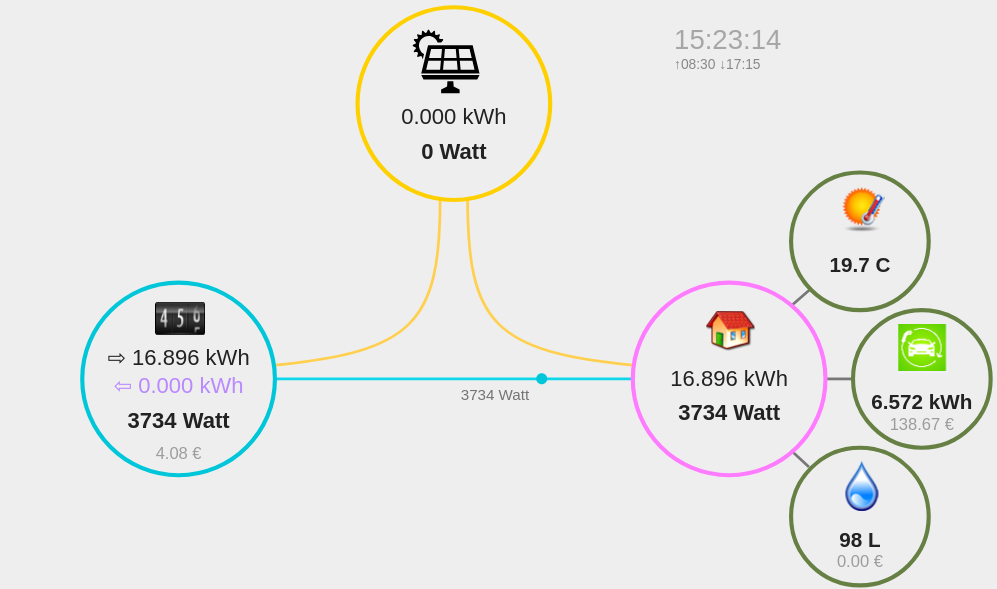

Ah, I see. Forgot to tell that I have it in use, but the icon is not that of drop of water but just 4 squares.
Wat I ment was that choosing the item "water" (the third option), shows only disabled. And choosing waterflow as a dummy does not appear eather, what seams to be logic.
Please let me know when the "water" option will be in use.
It would be nice that I, for now, could choose de waterdrop as the proper icon

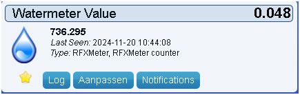

Now I was to quick to answer. The watermeter device in Domoticz has 2 values:
So, why not showing.

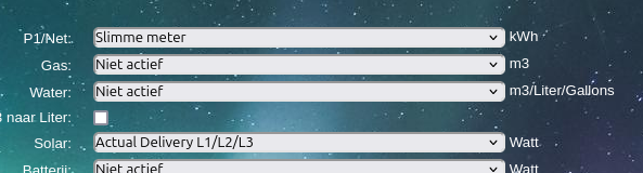

And here the widget
- watermeterwidget.jpg (99.83 KiB) Viewed 4151 times
Raspberry Pi 3B, Raspberry Pi 4, RFXCOM - RFXtrx433, Z-wave, ESP8266

You have to manually select it in the Setup - settings menu, tab energy dashboard. By default it is disabled. If you click on the pull down menu for water you should see the Watermeter Value device to select. Then click on Apply Settings and then it should be visible in the energy dashboard.
Ctenberge
- Posts: 40
- Joined: Friday 03 January 2020 15:41
- Domoticz version: 2022.2
- Location: Zwolle, the Netherlands
Re: Energy Dashboard (Build in)

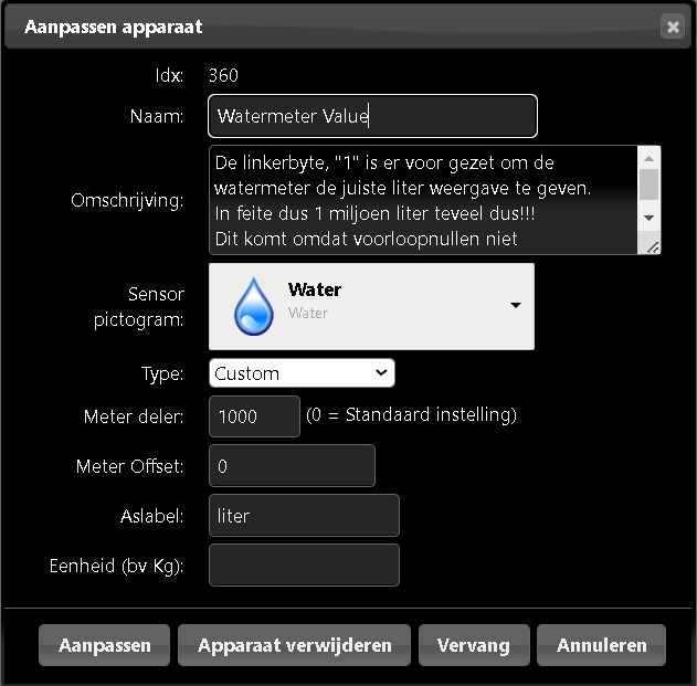

And now i saw what was wrong, the device type "custom"I changed it in watermeter and it shows:
Thank you for showing me the way.
- waterrmeter.jpg (19.25 KiB) Viewed 4150 times

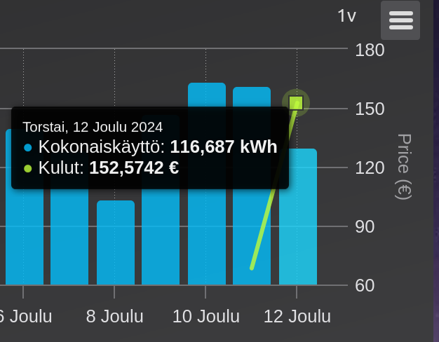

Are the dynamic energy prices working? I'm having incredibly weird results.
Now, my energy price custom sensor is using c/kWh units which I know are probably wrong, it should be €/kWh? Or perhaps €/Wh? Documentation doesn't mention anything about this.
The price for today has varied between 0.04€ - 0.10€ per kWh.
152/116 = 1.31€ /kWh which is nowhere near the real value even if you divide it by 100..

Did you use 116687 kWh for that day? Is this correct? or should it have been 116.xx kWh ? If that is the case, your kWh value is not correct.
Zuikkis
- Posts: 47
- Joined: Monday 20 February 2017 17:50
"," is the decimal point in Finnish locale. Domoticz seems to use "," and "." randomly depending on the page. kWh value is correct.gizmocuz wrote: Saturday 14 December 2024 8:11 Did you use 116687 kWh for that day? Is this correct? or should it have been 116.xx kWh ? If that is the case, your kWh value is not correct.

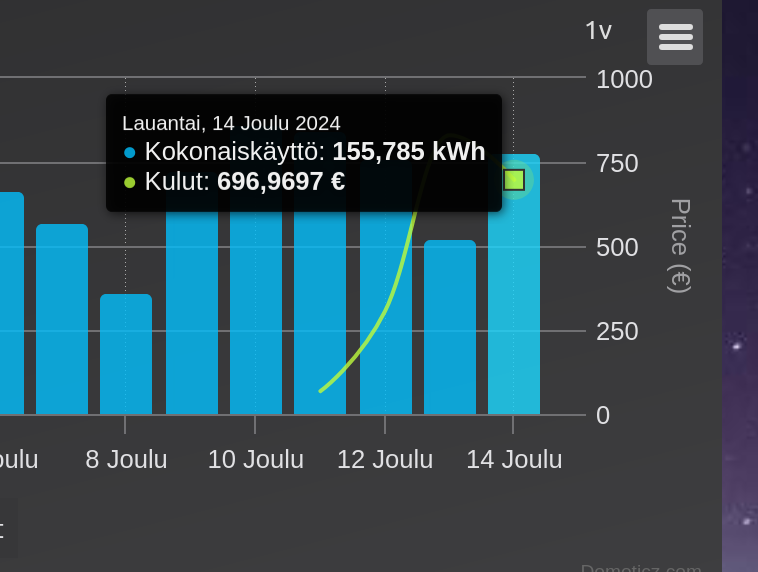

On the dashboard it shows like this:
And the report page:

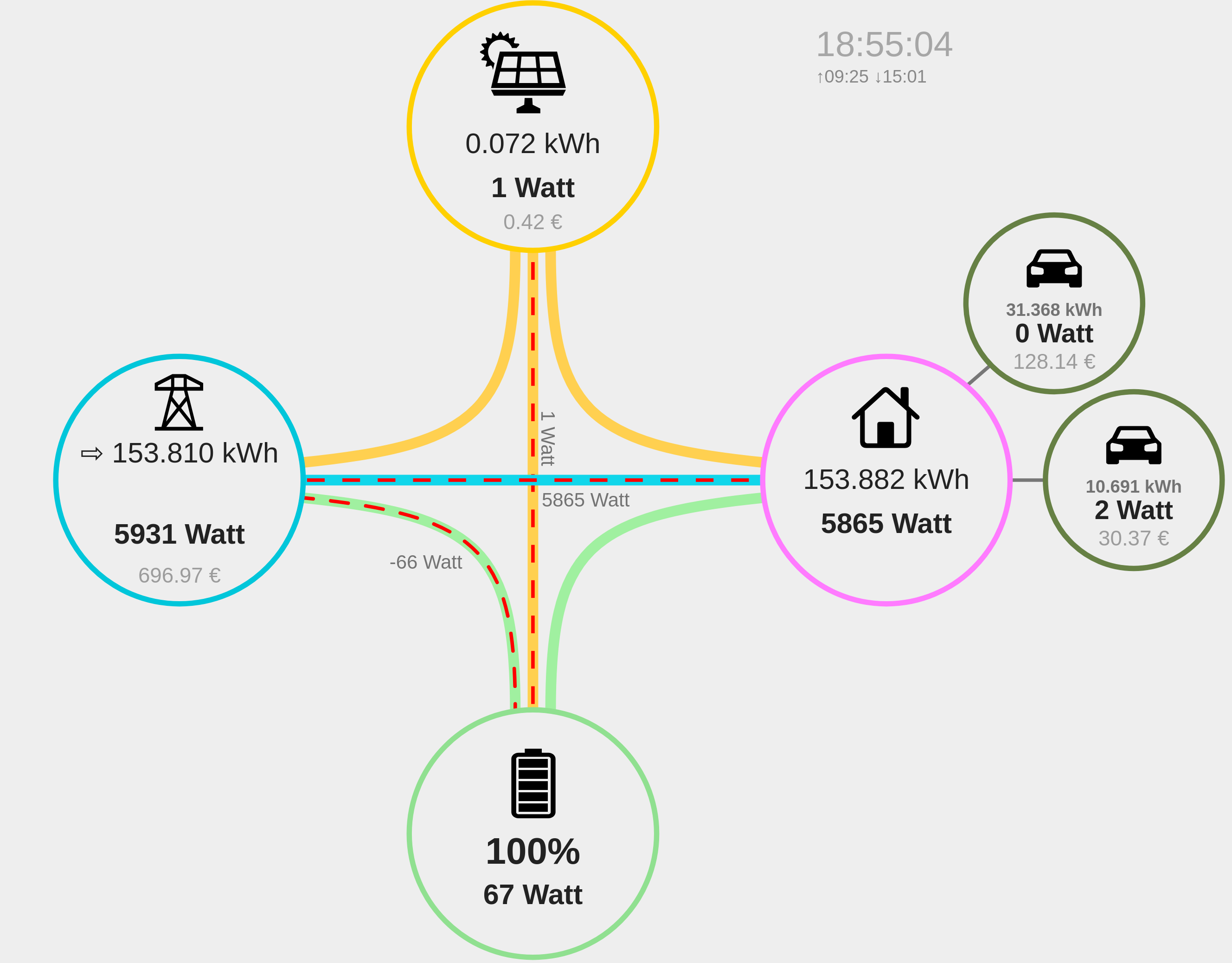

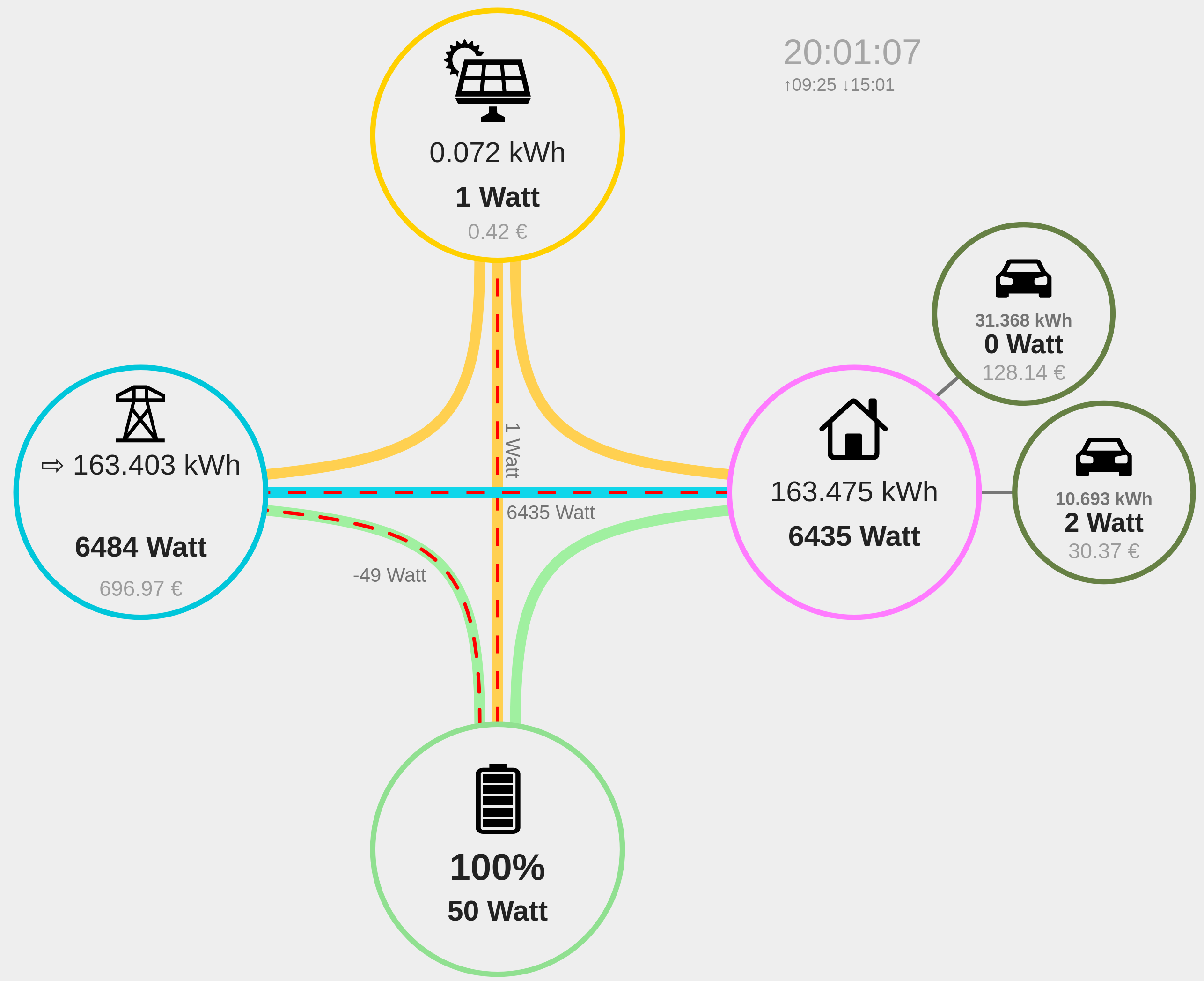

Here's the screenshot of the energy page for today:
Electricity price has been quite rock solid 7-8 c/kWh for the entire day. As you can quickly see, the math for each device seems to be different but none are correct.
Upper electric car: 128.14c / 31.368 kWh = 4.08 c/kWh
Lower electric car: 30.37c / 10.691 kWh = 2.84 c/kWh
Solar: 0.42c / 0.072kWh = 5.83 c/kWh (ok quite small numbers
Grid: 696.97c / 153.810 kWh = 4.53 c/ kWh

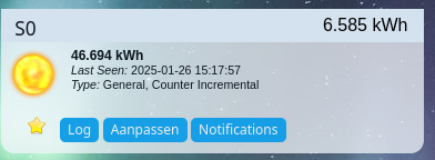

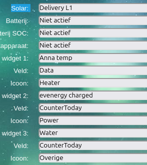

I have a small problem:
A S0 device is not available as Solar device in Energy Dashboard Setup. The type is general and Counter incremental. I have searched this topic but I couldn´t find it. The result is that thereś no value for the solar. How can I solve this?

Got it wrong device. Still the same problem, I cann´t select my S0 general counter in my Solar setting because it does not appear in the selection.
In the other free fields there you can choose general counters but not in solar
