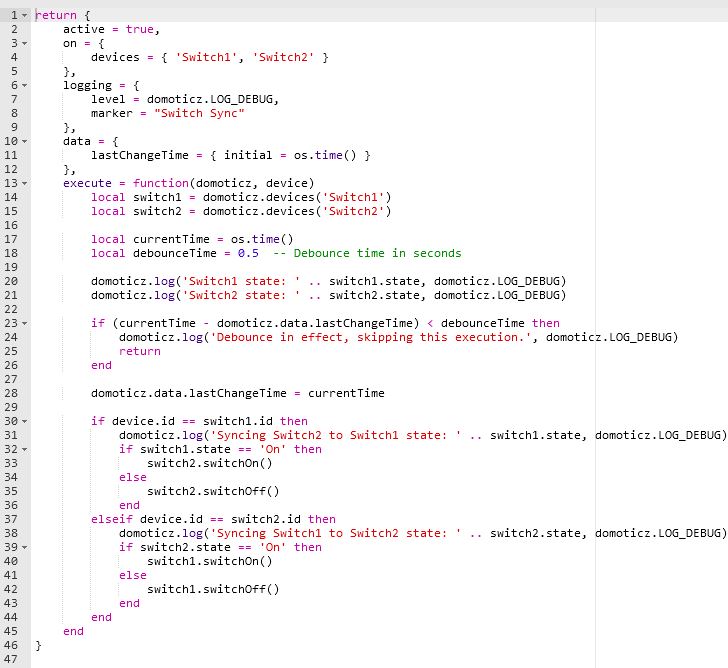

Well, I did read the wiki but still couldn't get anything to work my self so I went back to the AI and told it what happened when it didn't work and it's second attempt works just fine. I'm not trying to be lazy but now I have something that works I can learn from it myself as well. Just in case anyone wants to take a look this is what it wrote.
- Switch Sync.jpg (77.35 KiB) Viewed 1241 times

You might want to play with quietOn/Off() or silent() to get rid of the debounce stuff.
quietOn(), quietOff() ==>> status in domoticz will change but command is not send to physically attached device. Subsequent events are triggered.
silent() ==>> status in domoticz will change and command is send to physically attached device. Subsequent events are not triggered
