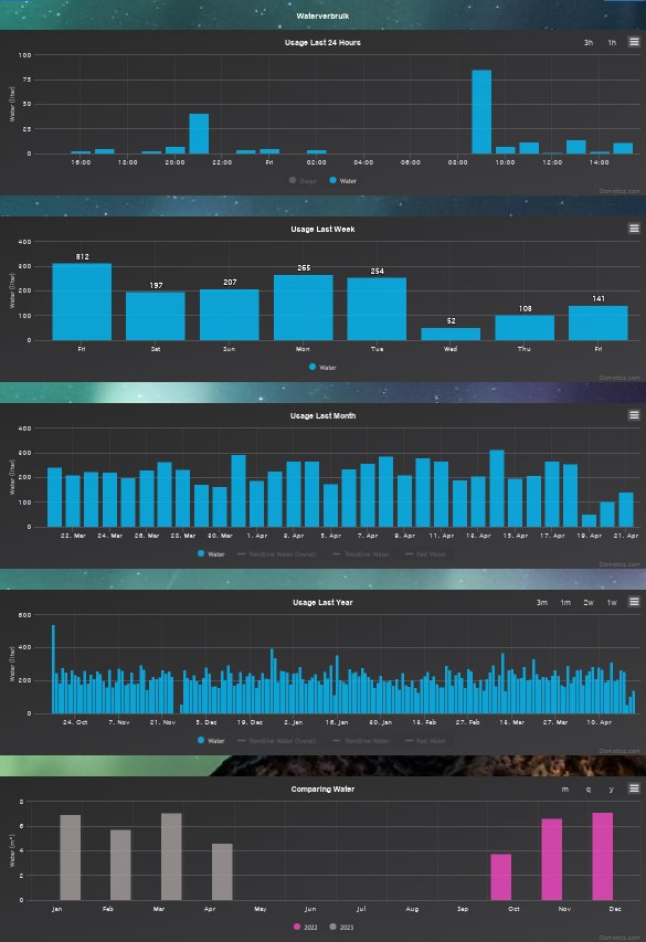

Well, after the joke, please find also my graphs.
Just FYI,
Like @kedi, I use Node-RED as well, for the Watermeter.

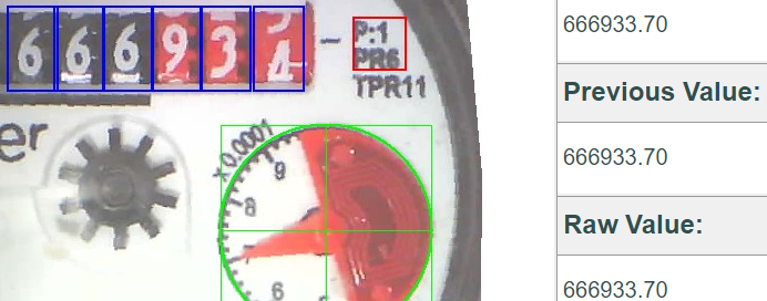

This is my image from the AI project. The value of "666933.70" is send to the Domoticz device.
Decimal shift is 0, so I am sending liters, up to an accuracy of 10 ml.
Rounded by Domoticz to liters.
All with the above Nodered function.
In Domoticz with a water counter divider of 1000 because costs are in €/m3
