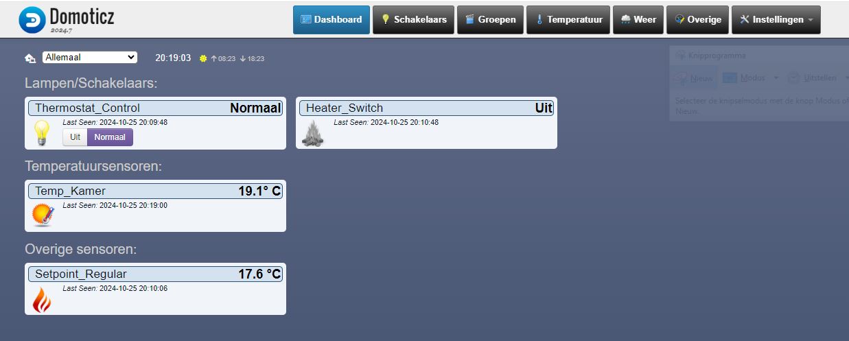

For a proof of concept I made a simple script for switching ON/OFF a relay that works as backup (parallel) when the original thermostat fails.
The boiler only works with ON/OFF not Opentherm.
The ON/OFF relay is based on a ESPEASY (heater switch) and works fine when toggled when the script does not run. So that works.
When I start the script and the setpoint is lower as the room temp the heaterswitch is off and the log shows regular logdata.
As soon as the setpoint is higher the heaterswitch goes to ON.
But then the log starts to fill rapidly with the same log lines.
I cant find the reason for this behavior.
As far as I could find all logs are switched off.

Backbone
Posts: 51
Joined: Thursday 22 October 2015 21:15
Domoticz version: 2023.2
Re: simple thermostat script
Post by Backbone »
Hello Walter,
Sorry for me misunderstanding.
My DZvents knowledge might be lacking heavily but I am willing to learn if I understand what goes on.
OK. You say I created a loop. So now I understand the behaviour shown in the script why it is repeating.
I already added the dz.devices(67).switchOff().checkFirst() in the code on your advice.
It might be I misunderstand that part and use it incorrectly.
The other option you mentioned is that I have to remove the heaterswitch from the devicelist.
But shouldnt there be one as dummy device to show on the dashboard and switch section to show the status.
Paco
