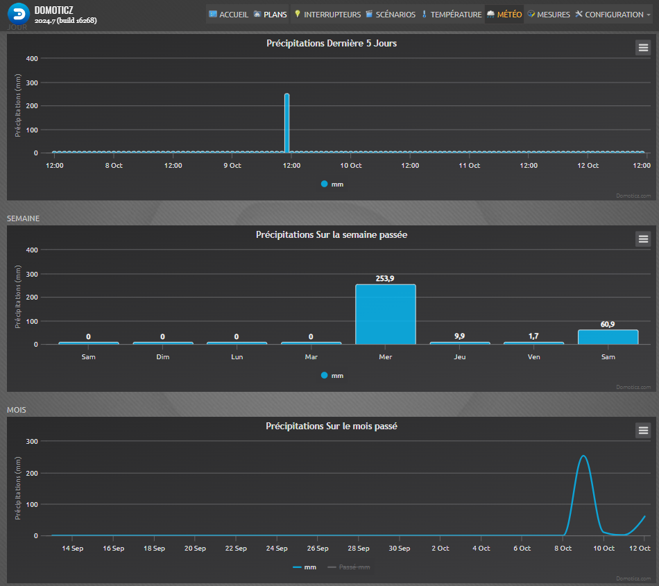

Some feedback after several days of using the beta version with the Ecowitt WS90
All sensors works fine in domoticz except the "rain" one which always return a zero value where the Ecowitt application returns some values
Patrick

Found the issue with the rain sensor. Please upgrade to beta 16268

gizmocuz wrote: Tuesday 01 October 2024 15:58 Found the issue with the rain sensor. Please upgrade to beta 16268
Thanks a lot for your support
I have upgraded to version beta 16268 and now I have some values for the Rain sensor in Domoticz.
But some values are not correct compared to the ones from Ecowitt application
The big value of 253,9 correspond to the date at which I have updated the Domoticz version, so it corresponds to the total value seen by the rain sensor at this date.But the value 60,9 for Saturday (today) on the weekly graph is not correct at all and also not in line with first graph (5 day graph)

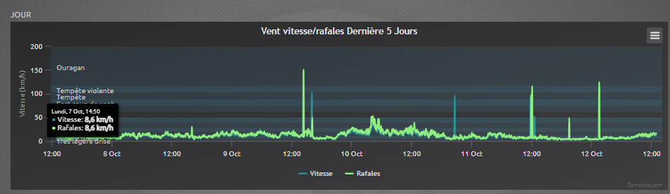

I have also noticed some "strange" values (very big values) for the wind sensor (see screenshot), those values are not present in the Ecowitt application and may come from erroneous decoding of the data stream may be from RFX868 !?
