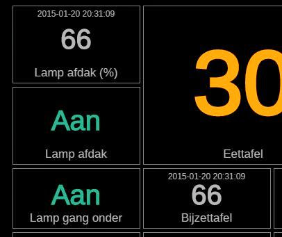

I have added the 'Last Seen' to the last version of jan_nl.
You can set per block if you want to add it or not.
I am also working on the buttons for setting the dimmer/setpoint.
i will post it when ready, should not take that long.

Domoticz version: 4.1x
Post by bbqkees »
I got the dimmer working, but not stable enough.
Often it will not dim below 13% (level 2) or it does not respond after a few consecutive clicks.
What i have done so far:
First I check if the cell is set to show 'Level', and the property 'HaveDimmer' is true, and then it will automatically show the dimmer buttons.
When you click on the button, it will set the current dim level to minus or plus one (one level translated to around 6%).
The change is visible instantly, no popups otherwise you would need to wait if you want to change it even further.
What I need to do:
-Make the response more stable.
-Decide what to do with level 0 and 1 (when it should be off).
-Build in check to see if it is off (because a dimmer can be off, and still have a level above 0).
-Change the buttons (these are from Bwired).
-Position the buttons left and right next to the value.
-Add a similar feature for the boiler setpoint.
