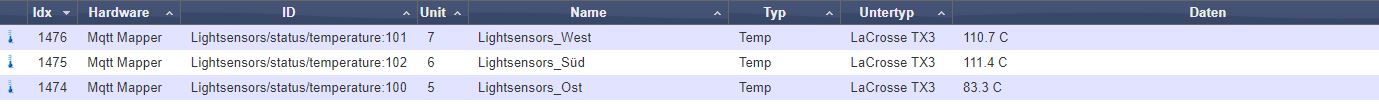

here we have the device list from MqttMapper

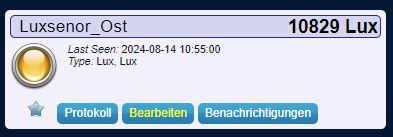

Yes but in Domoticz you can just define it as a Lux sensor with MQTT mapper and send the correct value. So then it looks like a lux sensor in Domoticz instead of a temperature sensor which it is not.
Device Type: 246 Subtype: 1 Lux Illumination (sValue: "float")
thaui
- Posts: 61
- Joined: Sunday 15 March 2015 19:53
- Domoticz version: 2023.2
- Location: Hamburg
Re: Lua, Read data from device

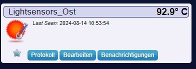

@waltervl Temperature is fine for me. If I have 93°C I know thats 10200lx .

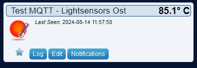

Many thanks for your continues work to find the problem. Sorry I was not clear on the topic content. Maybe the picture gives you the correct response.

I was imagining that, crossing with other parts of answer, but just wanted to be sure.
So, part to be taken in account is:
FlyingDomotic wrote: Wednesday 14 August 2024 11:38 Unless payload content is onlyIn this case, with a 2024.7, on RPi 4 with Buster and MqttMapper 1.0.42, sending payload "{"id": 100,"tC":85.1, "tF":185.1}" to "Lightsensors/status/temperature:100" properly loads data into Domoticz.Code: Select all
Using the following LUA script... I got : So, if payload is just {"id": 100,"tC":85.1, "tF":185.1}, we have to found what are the differences between your configuration. If otherdevices is correctly spelled, check for exact device name match (including leading/trailing spaces).Code: Select all
commandArray = {} -- loop through all the changed devices for deviceName,deviceValue in pairs(devicechanged) do if (deviceName=='Test MQTT - Lightsensors Ost') then print ("Device event fired on '"..deviceName.."', value '"..tostring(deviceValue).."', otherDevices '"..tostring(otherdevices['Test MQTT - Lightsensors Ost']).."'") end end return commandArray
