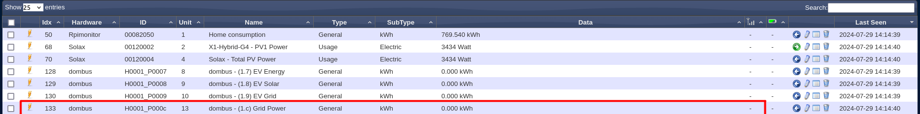

I agree that it is strange. The device is shown in the figure, general kWh, and so updateElectricity ought to work?

Note that I'm not overly familiar with the inner functioning of the plugin but, I know that some of its parameters need to be configured by editing the description of the devices and then saving them (example in figure below). What Paolo from Creasol said is that when the description is updated that forces the dombus plugin to constantly be sending a new configuration to the dombus EVSE module, and the end result is that the plugin ends up never starting to charge the EV when in solar mode. In other words, it seems that this problem triggers a constant restart of the EVSE module.
