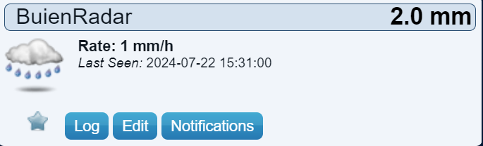

I have tried your 2 tests on a Docker play setup of Domoticz 2024.7 and they both worked fine on a dummy rain device:
http://localhost:8088/json.htm?type=command&param=udevice&idx=178&nvalue=0&svalue=100;2
Schermafbeelding 2024-07-22 153117.png (29.93 KiB) Viewed 1190 times
commandArray[#commandArray + 1] = {['UpdateDevice'] = '178|0|100;3'}
return commandArray
Schermafbeelding 2024-07-22 153530.png (29.35 KiB) Viewed 1190 times
