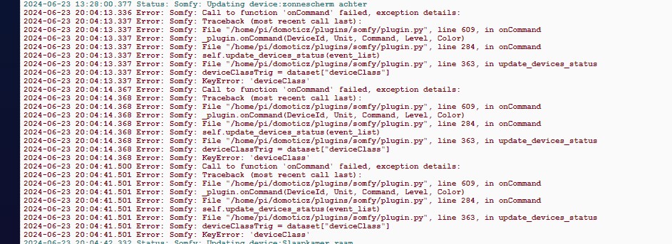

I am running the Somfy plugin for Domoticz (Somfy Tahoma or Connexoon plugin), version 4.20.22. It is running ok, only if one or more Somfy devices is (are) moving i see this error in the Domoticz logging (there are 3 devices moving). If the devices stop moving than the error messaging stops. I don't know where it's coming from, could it be a declaration in the Utils.py file? It is not a big issue but i like to know where it's comming from.

- Somfy_foutmelding.jpg (168.33 KiB) Viewed 1334 times

Try to go back to version 4.2.16 from the master branch.
I've seen also some errors with the beta version

Thanks,
Master version 4.2.16 isn't working right for me. I had to split out the state for an awning. That is the main different between the master and beta version. I don't know how to fix this error, may be someone with more programming skills has a solution...For now i stay at the beta version
