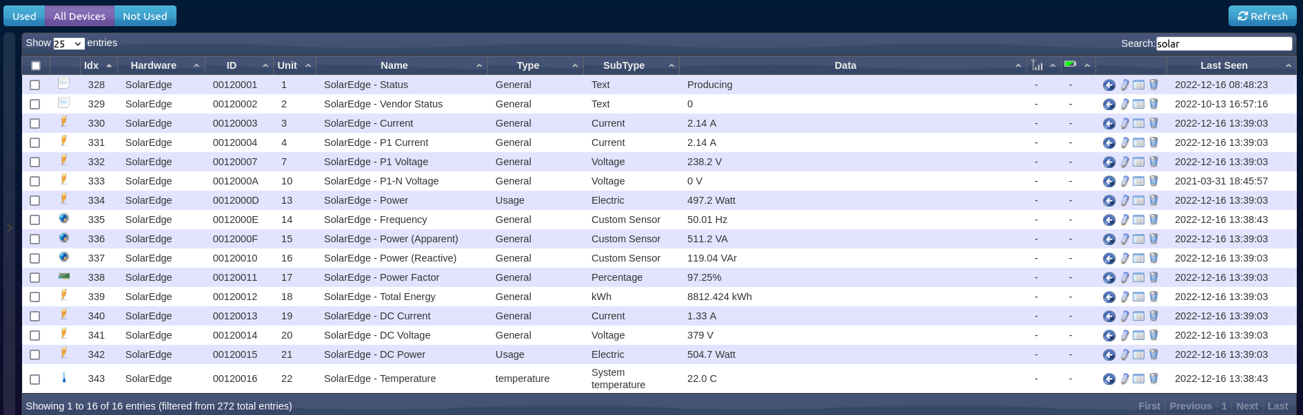

I have been experimenting with this dashboard and could use some help getting things to work. I get the readings for gas but not for electricity. The IDX for my (YouLess) P1 meter Electricity is 199.
The result for this code:
is
Which looks OK but nothing shows in the dashboard.
I can't get any result for my SolarEdge inverter. The hardware ID is 18 but that generates no results:
I have tried a number of Device ID's but none of the give any results. These devices are available in Domoticz:
Would appreciatie some guidance

did you try 339 for your solaredge ?

Yes, I did use that IDx but no result. I even restarted Domoticz to be sure.
Just to add: I use my SolarEdge through the Modbus TCP plugin from IronWolf (iirc). My Domoticz installation is running in a Docker environment (with the templates folder exposed to the system as per the Wiki).
EDIT: You rock! I forgot that I had to remove the cookies

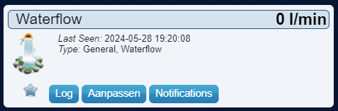

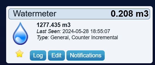

: I would like to add my water meter to this dashboard. I'm not very familiar with the coding, so maybe you can help me.
The watermeter is of type: General, Counter incremental. It shows in the right top corner the amount of today (in m3) and
in the box the total amount of used water m3.
Also I have a device called Waterflow - Type General, Waterflow, showing the waterflow in liter per minute. This could maybe also be added to the dashboard.
I would appreciate your help very much.

idP1 = Power - (Energy subtype)Sjonnie2017 wrote: Tuesday 28 May 2024 19:04Great! So it should work with a SolarEdge converterCould you show me which Domoticz device you used? Might be that I am using the wrong one
idSolar = Total Energy (General subtype) - kWh
In your picture, use 339

That's the device I use (339) which gives me this result. Will investigate further later on this day.McMelloW wrote: Tuesday 28 May 2024 22:06
Tx foor your reply!

Hi Sjonnie, my SolarEdge is connected to Domoticz with the SolarEdge Modbus TCP hardware. The values in Domoticz are directly from the inverter and change every 10 sec. The values in the app are from the SolarEdge website and change every 15 min. So the is some difference between Domoticz and the app.Sjonnie2017 wrote: Wednesday 29 May 2024 6:09 That's the device I use (339) which gives me this result. Will investigate further later on this day.
Tx foor your reply!
The only thing I did is changed the index number for idP1Meter; idGas; idSolar. And works like a charm. Much succes in getting it working OK.

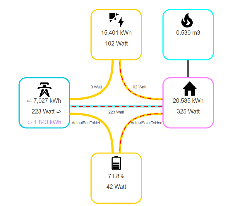

Looking great!! Maybe something to add by default (or as example)
Would be great if a Battery could be implemented.
As a battery can import/export (like the P1), maybe it is best to use a Usage/Electric (Watt) device for this?
I am sure 'heggink' is able to tweak his two sensors into one that puts in into a Watt device
But it would also be nice to display the capacity of the battery (like 2.4 kWh)
Maybe we need two templates, one without and one with battery?
Is it possible you can check this into a Github project?
Edit: I modified your file to include the support for a battery, I'm no expert in SVG !
(And the code is not correct/finished yet)
Please feel free to use/modify it
Maybe you can place all in groups and position the groups differently when a battery is used
- EnergyDashboardBatt.zip
- (3.9 KiB) Downloaded 187 times

@FireWizard, in the upcoming beta browser caching will be disabled for all custom template related items (page/images etc)
@MeneerKlaas, I am cooking something at the moment and optimized the SVG as well. Not sure if you are using a editor for this, but I am using a text editor now in combination with https://www.svgviewer.dev/
This is keeping everything tidy.
Adding a battery makes things a bit more complicated... some solar power can go into the battery as well
I also made the item outline a circle... It starts to look a lot like HASS this way...
Question, did you took these icons from HASS? Or did you found them on a website and are they free to use?
(For example, my battery icon is a found one)
Otherwise, it is not so nice to use them. For example, the Solar Panel icon looks like a combination of two icons specifically made for this
I know the home, gas are free to use
https://www.svgrepo.com/vectors/solar/
If I got the code right for the battery I will post the custom page here
- gizmocuz
- Posts: 3026
- Location: Top of the world
Re: Energy Dashboard - Template
I think it's working. At the top of 'UpdateScreen' you can enable some debugging to test
- EnergyDashboard.zip
- (4.72 KiB) Downloaded 157 times

Hi, @gizmocuz
I tested your latest version of the Energy Dashboard.
Unfortunately I'm not able to test a Battery, as I do not own it.
So I inserted -1 for idBattSetpoint and idBattSoc.
In this case the custom page displays a default value of 80%. Is that as intended?
You wrote:
One issue I discovered, compared with the first release of @MeneerKlaas.
I upgraded to the latest beta 16027 and at the same time I installed the version 1.2 of this template, followed by a restart of Domoticz.
After the restart Domoticz, I have to refresh the screen (by pressing F5) before I will see the actual values (sometimes multiple times).
Did someone noticed the same?
I'm not sure if it is caused by the new template (version 1.2) or the removal of the cache functionality in the latest beta.
Please allow me to suggest a few other changes.
1.
So, why not take the suggestion of @DiaDomo an add a "watermeter" to this dashboard.
I.m.h.o. it is not that complicated, as the functionality is the same as the that of the "gasmeter".
Also the EV car can be added, as suggested by someone else.
The charging of a Battery is exactly the same as charging the EV The difference is probably that the car will not discharge (to your Home)
The only thing is that we have to rearrange the picture a little bit.
Someone
suggested even to add it to Domoticz by default
Regards, Good job
You wrote:
It has not been a problem for me to clear the cache, i mentioned it, because other users might experience the same.@FireWizard, in the upcoming beta browser caching will be disabled for all custom template related items (page/images etc)
1.
I prefer the circle over the rectangular shape, but that is personalI also made the item outline a circle...
We should not copy a HASS functionality, but it is not bad if we take an idea and improve it.It starts to look a lot like HASS this way...
Someone
Move it from the "Custom" tab to the "Dashboard" tab is in my opinion a good place.Looking great!! Maybe something to add by default (or as example)
Regards, Good job
