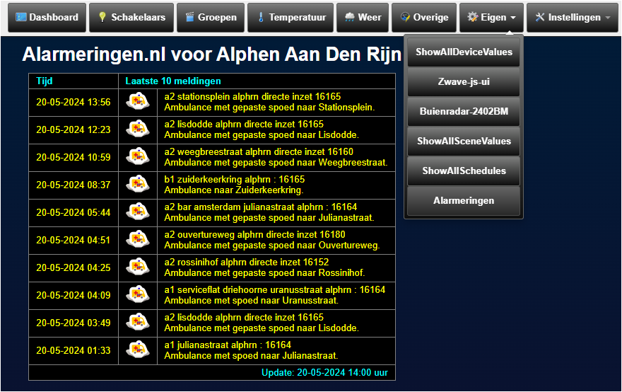

Now that I am rewriting my scripts in a new format, I would like to share some of these projects here. Maybe it will help someone.
Emergency services often pass by with sirens. Sometimes I wonder what is or was going on. One time it turned out to be a chimney fire just a few houses away.
All alarm reports in the Netherlands are published and can be accessed per region or city via RSS feed.
You can find your place at: https://alarmeringen.nl
Here you see the spelling of the name of your own city, to then use it in the URL.
Example of the data obtained for Alphen aan den Rijn: https://alarmeringen.nl/feeds/city/alph ... n-rijn.rss
I parsed this XML data in a script to post the latest notifications. I did not find it useful to put this information in a text device.
The space is too limited and it doesn't look nice. That's why I decided to place it in a custom HTML page, which is entirely created via the script.
This page can be called up via the Custom menu. See the picture below.
  • The script places the latest notifications in a dynamically created table with time, icon and description of the notification.
  • I have placed three pictures with these icons of ambulance, fire brigade and police in the directory: /home/user/domoticz/www/templates/images.
  • The script refers to that. The images are used as a link to further information on the website.
  • The html file is placed in: /home/<username>/domoticz/www/templates by the script.
  • Your own street name can be entered in the script and a notification email will be sent when there is an emergency in your own street.
  • NB. A variable 'lastAlarmNotification' is placed in global_data, to ensure that a notification that has already been sent for your own street will not be given multiple times. Create that as:

The result:
The first line in the description shows codes and overlaps with the second line. I kept it anyway, because it sometimes provides additional information.

janpep wrote: Monday 27 May 2024 21:25 First for your refresh.
I found out that this does not work.
Finally I found the suggestion to have to following line in the start script in /etc/init.d/domoticz.sh
DAEMON_ARGS="$DAEMON_ARGS -nocache"
and I am very happy with that.
I already using the nocache since years because it works better for me then with the cache on..
Second for the setup.
You asked for explain and you didn't ask for a quote.
So you have to fine tune yourself. Here a 'quick and dirty untested' setup to get the idea with city1 and city2 and two callbacks.
--Example with two callbacks.
--- Your settings ----------------------------------------------------------------
-- First set the used device index numbers and variables you might want to change.
local maxLines = 10                         -- Max number of lines to show in the table.
local locationToSearch = 'streetname'   -- Get a notification when streetname is found.
local al_emailTo = '[email protected]' -- Set E-mail adres to sent notification to.
local cityName1 = 'Your City 1'  -- Used in header, and used to strip from text.
                                        -- Use the same spelling that is found in description.
local cityName2= 'Your City 2  -- Used in header, and used to strip from text.
--Set the Fullpath to the html file. Example '/home/username/domoticz/www/templates/Alarmeringen.html'
local htmlFile = '/path/to//domoticz/www/templates/Alarmeringen.html'
--Set imageDir, where the icon_ambulance.web, icon_brandweer.webp, icon_politie.webp images are expected
local imageDir = '/templates/images' -- starting from root
--Set the URL to get the  rss for your city. Find city name at: https://alarmeringen.nl/plaatsen.html
-- Example region = 'http://alarmeringen.nl/feeds/region/hollands-midden.rss'
-- Example city = 'https://alarmeringen.nl/feeds/city/alphen-aan-den-rijn.rss'
local alarmeringURL1 = 'https://alarmeringen.nl/feeds/city/<city1>.rss'
local alarmeringURL2 = 'https://alarmeringen.nl/feeds/city/<city2>.rss'
		timer = {
			--'every 10 minutes',    -- Only used for testing.
		httpResponses = {
            'city1',       -- matches callback string for city1 below
            'city2'       -- matches callback string for city 2below
	logging = {
	    -- Level can be domoticz.LOG_INFO, domoicz.LOG_MODULE_EXEC_INFO, domoticz.LOG_DEBUG, domoticz.LOG_ERROR or domoticz.LOG_FORCE
        level = domoticz.LOG_INFO,
        --level = domoticz.LOG_DEBUG,
		marker = 'Alarmering-',
	execute = function(dz, triggeredItem)
        -- Set Local environment=================
        local _u = dz.utils
        local _h = dz.helpers
        local _d = dz.globalData
        local locationFound = false
        -- Local Functions go here =============
        -- Now start to do something ============
		if (triggeredItem.isTimer) then
			dz.openURL({
				url = alarmeringURL1,
				method = 'GET',
				callback = 'city1', -- see httpResponses above.
        -- Process the obtained data.
        if ( triggeredItem.isHTTPResponse ) then
            -- For City 1 ------------------------------------------------------
            if triggeredItem.trigger == 'city1' then
		--Here goes everything for city 1 as in the original script.
		-- Replace the following ENDING of the table
		tableContent = tableContent .. '   <tr>\n' ..
					'    <td colspan="3" align="right" style="padding: 3px 10px 3px 10px; color: cyan;">Update: ' .. updateTime .. ' uur</td>\n' ..
					'   </tr>\n' ..
					'  </table>\n'
		--with something that introduces city 2 and does not end the table. e.g.
					'    <td colspan="3" align="center" style="padding: 3px 10px 3px 10px; color: cyan;">City 2</td>\n' ..
					'   </tr>\n'
		--From Step 5. Write tableContent ----------------
		file:write(tableContent)
		-- From Step 6 skip writing the  fileFooter ------------------
		--Step 7. Close file ------------------------
		file:close()
		--Keep the notification part if you like that.
		--Ending this part with the second call for city2
                -- Retrieve the data for city2
			dz.openURL({
				url = alarmeringURL2,
				method = 'GET',
				callback = 'city2', -- see httpResponses above.
            end -- city 1
            -- For City 2 ------------------------------------------------------
            if triggeredItem.trigger == 'city2' then
		--Here goes everything for city 2 as in the original script. BUT
		-- Skip to remove the existing file but re-open it for appending.
                 local file = io.open( htmlFile, "a" )
		--Skip Step 2 to  Write fileHeader ----------------
		--Keep Step 3. Get and write tableContent in loop  ----------------
                --Keep Step 4. Append table footer with update time and close the table  -----
		--Keep Step 5. Write tableContent ----------------
		--Keep Step 6. Write fileFooter ------------------
		--Keep Step 7. Close file ------------------------
            end -- city 2
	-- Keep the remaining part and check if all the if - end combinations are still correct.
-- That's All --------------------------------------------------
I hope this helps you to find the way through it, but I think here it ends for me.
Thanks! Will check it out!
