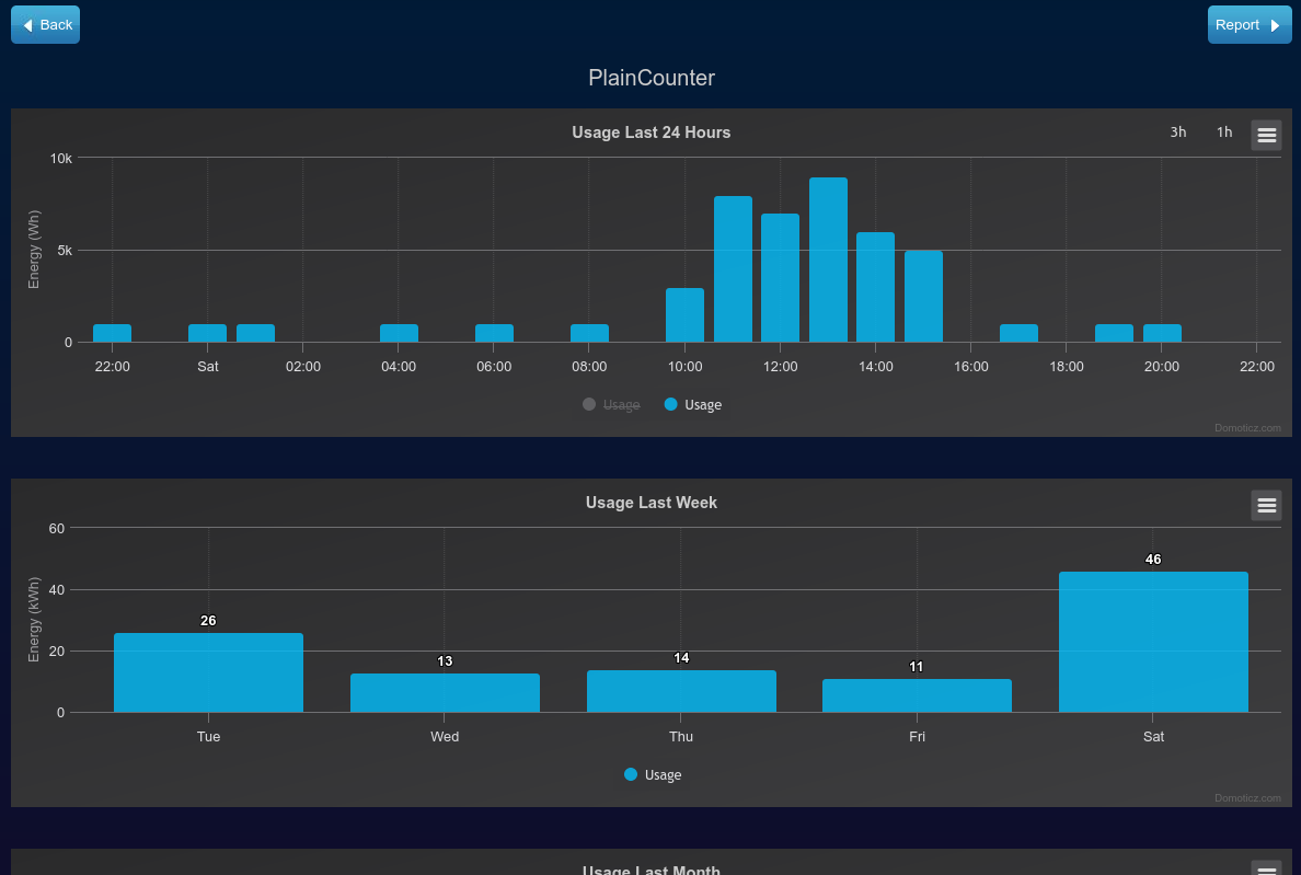

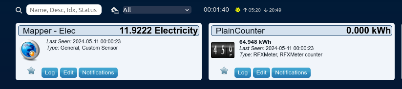

Hi again. It seems like the counter (I've called it PlainCounter here because I tried so many types) is sort of working but....
Except for the time periods when our electric vehicle is plugged in and charging (like it was today), the Usage Last 24 Hours seems to show lots of bars which are all the same value - 1kWh

Looking back over the week, most days seem to show slightly lower totals than the actual. Last night (Friday), just after midnight, when the counter had zeroed, I took a screenshot showing the MQTT mapper value at 11.9222:
Screenshot 2024-05-11 at 00-01-22 Domoticz.png (42.1 KiB) Viewed 2859 times
but in the previous screenshot for the last week, Friday shows a value of 11.
Just wondering if you have any thoughts/tweaks on these 2 points please?

2024-05-14 10:00:05.993 Status: dzVents: Electricity: Counter=148.904, currentValue=4.14855, previousValue=4.14855, delta=0.3075166666667
2024-05-14 10:20:04.780 Status: dzVents: Electricity: Counter=149.212, currentValue=4.3060666666667, previousValue=4.3060666666667, delta=0.15751666666667
2024-05-14 10:40:04.202 Status: dzVents: Electricity: Counter=149.37, currentValue=4.4296666666667, previousValue=4.4296666666667, delta=0.12359999999997
2024-05-14 11:00:05.229 Status: dzVents: Electricity: Counter=149.494, currentValue=4.6752, previousValue=4.6752, delta=0.2455333333333
The currentValue and previousValue on each line are the same.

Oups ...
A made a istake, loading previousValue too early. Try with the following script, which display it before updating it.
-- Example managing daily counter reset every day into cumulative counter
    on = {devices = {'Mapper - Elec'}},                                         -- Device containing today's value
    data={previousValue={initial=0}},                                           -- Permanent data to save precious value
        local counterDevice = domoticz.devices("PlainCounter")                  -- Load counter device
        local counter = counterDevice.counter                                   -- Load counter value
        local currentValue = device.sensorValue                                 -- Load elec value
        local delta = currentValue - domoticz.data.previousValue                -- Compute delta since last pass
        if delta >= 0 then                                                      -- Value incremented
            newCounter = counter + delta                                        -- Add delta
            newCounter = counter + currentValue                                 -- Reinitialized, add value
        print("Electricity: Counter="..tostring(counter)..", currentValue="..tostring(currentValue)..", previousValue="..tostring(domoticz.data.previousValue)..", delta="..tostring(delta))
        domoticz.data.previousValue = currentValue                              -- Save previous value for last pass
        counterDevice.updateCounter(newCounter)                                 -- Update counter
Part of log that will be interesting is at midnight. However, it seems that data is loaded every 20 minutes. Very probably, power consumption between 23:40 and 0.00 will be lost as never sent. Reducing the interval to 1 minute will reduce missing data (you'll loose only 1 minute instead of 20).
