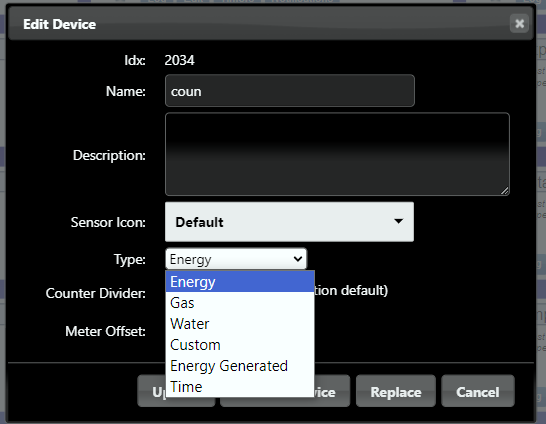

fantom wrote: Thursday 09 May 2024 18:18 1) Maybe Fan device is better for 1/min
2) Domoticz have something like "counter" also. But I don't know how it works etc.
3) Who damages big numbers ? plugin or domotcz ?
1) I will check if other uses for 1/min unit before
2) I know counter quite well because I did some changes on it myself in Domoticz code. This is quite adapted to kWh for instance, but we have the same problem as other devices, the unit is missing to be sure to map data type correctly
3) Domoticz :
read -v WaterpressureMeasureCounter
bai WaterpressureMeasureCounter =112
read -v PrEnergyCountHc1
bai PrEnergyCountHc1 =29915587
read -v FanMaxSpeedOperation
bai FanMaxSpeedOperation =5550
The plugin doesn't add the "+e07" itself

fantom wrote: Thursday 09 May 2024 18:33 And maybe device on/off can have another type in domoticz ? "On/Off" instead "contact".
I'm not sure ...
It depends if device is writable. If it is writable and you didn't set read-only in parameters, the device will be created as on/off. But you are free to change that by editing the device in Domoticz.
I published a version 2.0.9 which will create a fan custom sensor if type is 1/min. I didn't use counters because the way they work is very specific (you must maintain an absolute counter value, and add an increment at a regular basis).

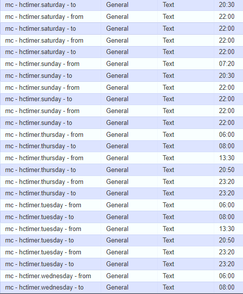

Devices with sec and min can also be time device (like hour)
And devices like hh:mm and hh:mm:ss also can be time type ?

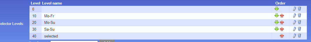

And i think this is bug. Domoticz shows the value incorrectly or plugin set bad value.
I don't know where these values (20, 30 etc) come from.
I think, svalue need to show this same what nvalue, or maybe text like "Mo-Fr" etc.
Edit: Ok. This nvalue is selector index * 10. That this is small bug for showing value I think.
Edit 2. But i don't know, what do You set in nvalue?

fantom wrote: Thursday 09 May 2024 20:44 Edit: Ok. This nvalue is selector index * 10. That this is small bug for showing value I think.
That's the normal behavior, Domoticz show the Set Level in devices tables (index of selector switch x 10 as you guessed), but in the interface, you should have a selector switch positioned at the right value.
fantom
Posts: 269
Joined: Thursday 26 March 2015 10:40
Location: Poland
Re: Python Plugin: ebusd
Post by fantom »
Yeah. I will try fix it.
And what do You set in nvalue?
And i don't know, why first value on list is empty
ps. Maybe this need to be general/selector ? nor switch with level.

fantom wrote: Thursday 09 May 2024 21:42 And what do You set in nvalue?
I think nvalue is ignored.
I need to check for first value empty, it's weird.
This should be general selector, I think you have text because you begun in read-only mode. In next version, I will change automatically the switch type when switching from read-only to read/write and from read/write to read-only.
