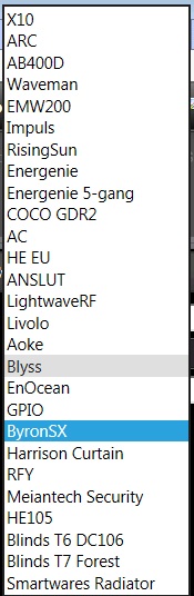

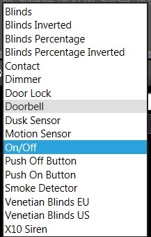

I'm also running firmware 236, but no joy on the cheap doorbell.
Removed battery from the button, unpluggued doorbell itself, no joy.....
This is what I see for switch types
Switch types
Switch types
switch types.jpg (31.41 KiB) Viewed 7378 times
In the type drop box below that I see this:
Types
Types
switch types2.jpg (39.15 KiB) Viewed 7378 times
The switch still does not detect, and I do not see the SelectPlus anywhere, am I missing something?
Think I will just buy another one....

someones_domoticz wrote:I'm also running firmware 236, but no joy on the cheap doorbell.
Did put back the battery in the switch and pressed the button, it should be available in used devices section
You wont find it there (your screenshots)
