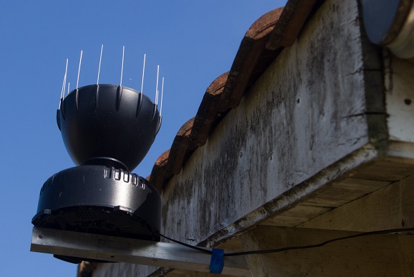

Materials:
  • Davis 6464M rainmeter: 149€
  • RJ11 Breakout BOB-14021 at sparkfun $2.10
  • RJ11 6-Pin Connector PRT-00132 at sparkfun $1.50
  • ESP32 DFR0478 at DFRobot (any other ESP32 should work): $8.90
  • Micro USB power supply
Why such an expensive rainmeter: because this is the only reliable rainmeter according to the members of infoclimat forum.
The rainmeter is a part of the vantage pro 2 weather station at more than 1000€ not including ethernet gateways annual service charge...

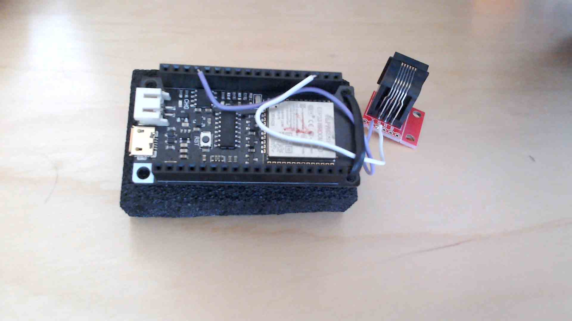

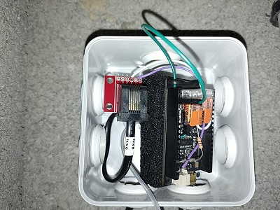

Wiring:
Connect 4 & 5 from RJ11 to GND and IO25/D2 of ESP32: wire can be reversed because connected to the reed switch inside the rainmeter
Note: ESP32 and RJ11 are inside house and rainmeter outside
RJ11 connection between rainmeter and ESP32

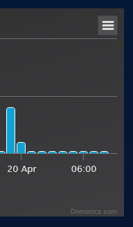

Bad new: the ESP32 detect false rainmeter bucket
The TFA
The ESP32
Maybe the pullup resistor is too high: around 50kohms according to ESP32 users. The wire to the rainmeter is 15 meters long.
I tried to add a 1000 ohms resistor as pullup.
But no luck: I had 3 false bucket during this post writing (10 minutes).
Domoticz V2024.7

mgugu wrote: Saturday 20 April 2024 19:06 This may be an electromagnetic interference problem (15 meters is a lot), several checks possible:
Thank you. I simplified the wiring: nothing plugged to the ESP32. Only the INPUT_PULLUP: I still have the problem: the interrupt fire 3 times per hour up to one time per 8 hours.
mgugu wrote: Saturday 20 April 2024 19:06 But definitely it is not a Domoticz problem but an electronic one
According to this experiment: that's not a Domoticz problem neither an electronic problem but an Arduino/ESP32 problem.
