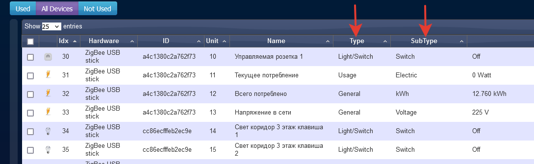

You have to realy know the type/subtype of your sensor (setup -> Devices page) to choose the right method of updating.

Opbrengst device is type is general subtype kwh
The value in the device is correct but it needs to be kw instead of watt

this type of device shows only in Wattsedwin1234 wrote: Sunday 14 April 2024 17:09 Opbrengst device is type is general subtype kwh
